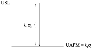

Step 2. Set a value known as the upper acceptable process mean (UAPM) at k1sx below the USL, where sx is the capability standard deviation of the x's. If the x values are roughly normally distributed, then using k1 = 2 will produce an AQL value of approximately 2.5% (see Figure 1).
Figure 1: Graphical Display of UAPM

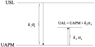

Step 3. Add k2s to UAPM to arrive at the upper acceptance limit (UAL) for the sample , where s is the standard deviation of the 's. The value of k2 sets the probability of acceptance of material that has a quality level of AQL. Choosing k2 = 2 would set the probability of accepting material that has a quality level of AQL to approximately 0.975 (see Figure 2).
Figure 2: Graphical Display of UAL
Remember that the standard deviation of the 's is the standard deviation of the x's divided by the square root of the sample size, i.e., where n is the sample size.
