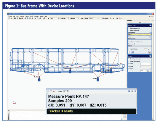

Bus-frame inspection at Novabus formerly required two inspectors and took up to 10 man-hours per bus. Laser trackers were used for large-volume measurement within the bus frame and its undercarriage. Portable arms were used for more detailed parts of the frame as well as for probing into mounting points that are difficult to measure with a tracker due to laser line-of-sight issues. In the old process, inspectors could script individual measurement operations, but there was no way to perform measurements collaboratively throughout the vehicle or to analyze the results overall. Scripting was limited to individual programs that inspected isolated details, rather than the entire vehicle. Operators had to know the entire process, which scripts to use and where, and how to best position the equipment. They also had to be experts in using the metrology software. Analyzing inspection results was time-consuming and often involved downstream analysis and interpretation. The process was long, could be performed only by trained experts, and didn't always provide the quick and reliable feedback needed to make informed manufacturing decisions.
Automating a collaborative inspection solution
Novabus solved these issues by using a collaborative and automated inspection process from Metrix Software Solutions. This involved combining a laser tracker and portable arm to script a collaborative measurement process for an entire vehicle. Because measurements are needed throughout the frame interior, exterior, and undercarriage, the process also involved positioning the portable CMMs at several locations within the measurement volume. To perform a vehiclewide analysis of the measurements to nominal design geometry, the measurements had to be integrated into a single network.
The solution involved using anchor points within the frame that could be repeatedly measured and act as a common network to bundle the overall measurements. Measurements taken at a single inspection location with an arm were integrated into the overall vehicle profile using features on the vehicle that were also measured with the tracker.
The measurements were then inspected automatically against design nominals using the automation software's built-in evaluation engine. The system uses design nominals to align all measurements into the vehicle coordinate system and compare measurements against nominal design points and surfaces. For example, hole locations for equipment mount points on the frame, door, and window openings, as well as various axes for hinge lines and equipment mounts, are all inspected against nominal geometry and specified tolerances.

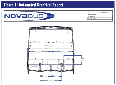

Reporting is often overlooked when automating inspection processes. In the end, an inspector wants to see clear, concise results so that issues can be communicated quickly within the organization. Lengthy text-based reports and spreadsheets aren't effective for this task, so at Novabus, the reporting process is completely automated and graphics-based. Measurement results and variations from nominal geometry are shown entirely in drawings. This makes understanding inspection results quick and easy for everyone on the shop floor. In addition, the first page of the report summarizes out-of-tolerance exceptions, so problem areas are quickly identified. These basic results can make a big difference in how the information is used. An example of a typical automated graphical report is seen in figure 1 below.

Having a measurement process that provides timely feedback is a tremendous advantage. Inspectors no longer have to return to the office to crunch numbers; inspection results are presented graphically on the 3-D model and through reports incorporating 2-D drawings. Combining 2-D drawings with traditional dimensioning and tolerancing allows shop personnel to understand results and make corrections during the manufacturing process. With dimensional results available in real time, downstream assembly processes can immediately be evaluated by manufacturing engineers and potential problems averted.
