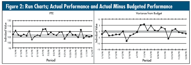

My friend knew better than to try to fool me, so I asked her for the data. I plotted the two run charts seen in figure 2. The one on the left is a run chart of her actual performance, and the other is a plot of this actual performance minus the budgeted performance.
Her process was perfectly designed to get the results it has always gotten.
How can this make sense? What about the special cause in the graph on the right (observations 12–19 above the median)? Well, there was a process change… of sorts. (More about that next month.)
