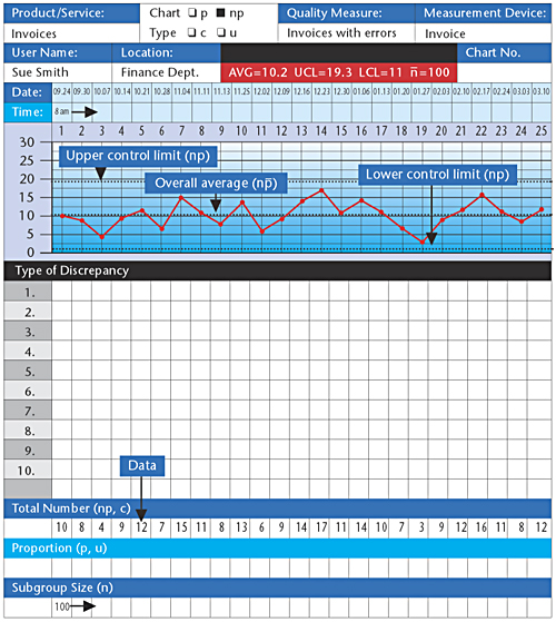

With that confidence, he arranges for the pharmacists to gather data relating to missed medications. Sedrate knows he'll have plenty to work with because the pharmacy has been collecting data for the Joint Commission on Health Care Accreditation. He decides that the data should be considered as attributes data because he'll be measuring nonconforming items, defined as those medications that fail to be delivered on time. Further, he believes that an np chart is the appropriate way to analyze the data because, in effect, he'll be examining the number of deliveries with mistakes.
He develops the chart below, based on the data provided by the pharmacists.
However, when Sedrate analyzes the chart, he's disappointed that the system seems to be in control. "I was hoping to see lots of out-of-control points so we could eliminate special causes," he mutters to himself, deciding that the np chart gives him nothing dramatic with which to enhance his portfolio in the hospital. He's so worried that he finds himself losing sleep at night. Is his anxiety merited?
Sedrate's high blood pressure is pointless because the pharmacy process gives him plenty of opportunities to improve quality. The point is not just to identify out-of-control conditions but to improve the process. The np chart reflects that the process is now generating an average of 10.2 nonconformities per week.
By brainstorming and using cause-and-effect analysis, Pareto diagrams and other problem-solving and data-analysis tools, Sedrate's improvement team can identify ways to further reduce the number of missed prescriptions.
