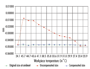

Figure 2: Workpiece Dimension vs. Temperature
Thus, even if the plant floor is extremely hot or cold, operators instantaneously obtain close to the same measurement result they would if they were to take the part into a temperature-controlled gage room, let it stabilize during several hours, and take the measurement at a controlled temperature, as seen in figure 2.

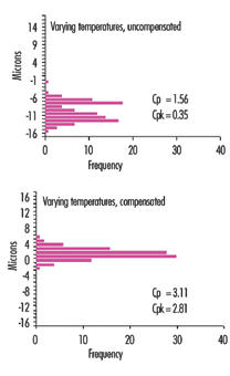

Process-capability studies have been conducted by major auto manufacturers on several production lines both before and after introducing temperature-compensated gaging. (See figure 3.) The reduction of measurement variation in the process allows closer and more accurate control of the process, producing dramatic results of 200 percent and greater in Cp and Cpk measurements.

Figure 3: Temperature Variation
vs. Cp
Comparison of process-capability study results with and without temperature compensation
