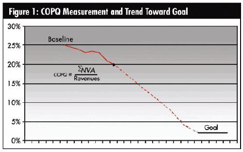

At ABB we use a metric known as cost of poor quality (COPQ). COPQ is measured by estimating the cost of all efforts undertaken in an organization, including materials and processes used in assembling our products, that don’t provide value to customers. In the lexicon of lean manufacturing, these are nonvalue-added activities. At ABB, COPQ is the sum of all nonvalue-added costs divided by the total revenue that’s generated. The resulting measurement is the percentage of revenue that’s lost due to waste.
COPQ is measured, reported, and tracked in each of the business units. COPQ is used to measure progress within the organization and to identify best practices that can be shared throughout the company. COPQ is a metric and a learning tool, helping an organization to understand what’s nonvalue-added and to establish opportunities for improvement.
Measuring COPQ establishes a baseline, and eventually a trend line (heading, hopefully, toward the goal), as seen in figure 1, below.

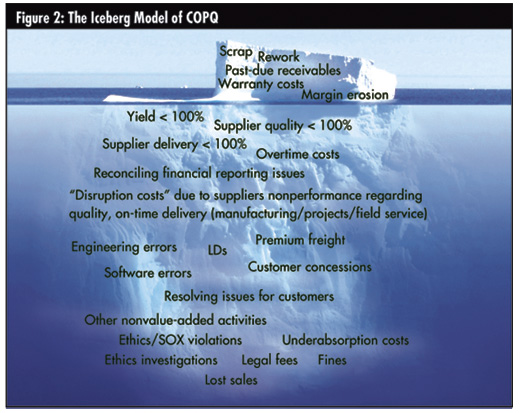

The value of COPQ Inspection, waste, rework, and warranty costs are the most obvious nonvalue-added activities that go into the COPQ metric. It’s estimated that up to 10 percent of revenue is wasted on these activities, which are fairly easy to measure and are understood by most people, even those not practicing in the quality field. In a typical organization, a great deal of effort is spent in improving these metrics. It’s easy to gain support and encouragement to eliminate these wastes.
However, as seen in figure 2, below, inspection, waste, rework, and warranty costs are only the tip of an iceberg composed of many unknown and misunderstood nonvalue-adding activities. The nonvalue-adding costs from waste, inspection, warranty, and rework are dwarfed by the root causes lurking unseen beneath the waterline.
Most alert organizations realize that losses can accrue from wastes such as excess inventories, unnecessary motion, and supplier nonconformance. The enlightened company will also see that losses can occur from more obscure wastes, such as unnecessary paperwork, large lot sizes, and excessive auditing. These wastes lead to additional estimated COPQ losses of up to 15 percent of revenue.
In a typical facility, there’s normally much less effort spent on improving (and profiting from) these more esoteric nonvalue-added activities. That’s because, in part, they’re difficult to characterize or can only be quantified with “soft” numbers. So it’s difficult to gain support for their elimination. But make no mistake: These are real opportunities and often the root causes of wastes.

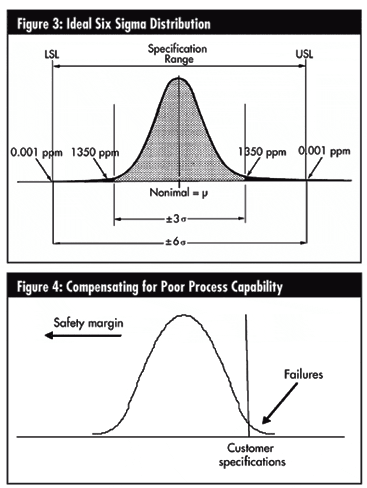

Consider the Six Sigma distribution shown in figure 3, at right. This simple and eloquent chart shows the interaction between product specifications and process capability--the beauty of a Six Sigma design.
A two-sided Six Sigma design can be difficult and expensive both to achieve and sustain. Most designs are single-sided. A specification will call for a hole smaller than, a weight larger than, or a temperature lower than a nominal value. Although a single-sided design specification at first glance might appear helpful, it can mask serious flaws.
Consider the situation shown in figure 4, at right. Here the specification calls for the process to be capable of delivering a measure less than a nominal value, but the process capability is poor and widely distributed, so failures sometimes occur. In this situation it’s easy for the engineer to add a safety margin to prevent failures. If this “fixes” the problem and failures no longer occur, it appears that waste is no longer being generated.
In fact, waste can actually be increasing and going unnoticed because it’s hidden to most observers in most industries.

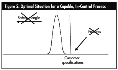

Figure 5, at right, shows an optimal situation where processes are capable, well understood, and in control. In this instance safety margins aren’t necessary, and failures don’t occur. In an organization where this methodology is followed, costs can be contained, designs can be optimized, and a competitive advantage can be maintained.
