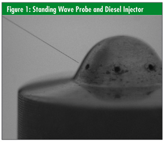

One of the major manufacturing challenges is to measure the geometry of these holes so that computer models may be validated and manufacturing processes enhanced. This capability will affect the design of new injectors and lead to increased efficiency and lower emissions. Federal laws dictate that, by next year, off-road diesel engines must lessen particulate output by 95 percent and NO 2 by 90 percent. “Regulating Air Pollution from Diesel Trucks: A Model Rule for States,” a July 2001 report issued by the State and Territorial Air Pollution Program Administration (STAPPA) and the Association of Local Air Pollution Control Officials (ALAPCO), estimated that reducing emissions could prevent 8,500 premature deaths in the United States per year and save up to $67 billion annually. (View online at www.4cleanair.org/DieselTrucks.pdf.) This is one of many compelling examples in micromanufacturing that will affect our social and economic well-being.
Achieving this capability will require “the development of novel probes that are capable of measuring the tiny features that are encountered in the field of microsystems,” according to the United Kingdom’s National Measurement Laboratory, in its report “Nano Dimensional Metrology.” In terms of metrology, the difficulty is that the measurement sensor should be at least ten times smaller than the measured feature (i.e., the size of the hole) to adequately measure the feature’s form and the asperities residing on it. Taking this into account, a tactile probe would need to measure less than 5 µm in diameter with a length of up to 2 mm to allow deep measurements into the feature. That’s a 400:1 aspect ratio.

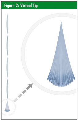

During the past three years, InsituTec Inc., a provider of ultra-precision measurement solutions, has partnered with the Center for Precision Metrology at the University of North Carolina to focus efforts in innovative microscale sensors for dimensional metrology. From this work, a novel tactile sensing method has emerged known as a standing wave sensor. This is a new class of sensor utilizing ultrasonic frequencies to shape a pronounced tip on the end of a microscale fiber. Several globally recognized metrology companies commercially produce vibrating tactile probes. However, the standing wave sensor is unique because the tool purposely creates or shapes a pronounced tip on the end of the sensor by employing ultrasonic frequencies. Ultrasonic is typically classified as producing drive frequencies from 20,000 to 3 million times per second. In the case of the standing wave sensor, the fiber is vibrated back and forth 32,000 times per second using a crystal oscillating tuning fork. A time-averaged picture of the oscillating fiber will produce an image of the oscillating probe as a solid volume, traced out by the path of the fiber’s outer surface, which will have a defined geometrical pattern on the end, as seen in figure 2 at right. The actual probe is composed only of the fiber; however, the virtual tip is composed of an integral of the path produced by the tip. Furthermore, the outer locus of the virtual tip is composed of the total sum of motion produced by the very end of the fiber, thereby generating a pseudo-field capable of interacting with other solids and surfaces in near proximity. This programmable field (or virtual tip) may be strategically employed in both microscale and nanoscale metrology.

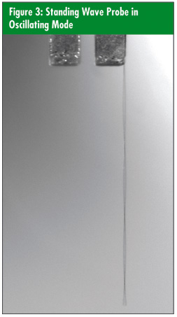

The sensor uses resonant frequencies to generate the standing wave as well as phase-sensitive electronics to detect interactions between the tip and workpiece. First, the tuning fork provides both an input and output response. In practice, a drive signal is transferred to the tuning fork resonator to drive the first mode-resonant frequency. The output response of the tuning fork is monitored. Once the fiber’s virtual tip is contacted against a specimen, the output signal from the tuning fork will change in both amplitude and phase. These signal characteristics are then signal-conditioned and used as the tactile probe’s contact signal. For example, the sensors can be attached to custom metrology motion-control devices capable of positioning to 1 nm. In a touch triggering mode, the sensor has demonstrated 10-nm repeatability. The sensor is currently being used in scanning mode as well. In this configuration, the sensor is locked at a constant force of less than 1 µN and then scanned continuously along the surface using the same constant force. This approach enables approximately 100 to 1,000 data points per second to be extracted from the measurement process.
The virtual tip is shaped at the end of a 4 mm-long fiber that has a cross-section of 7.5 µm, a 500:1 aspect ratio. The tip shaped at the end of this aspect-ratio sensor will swing further out than anywhere else along the shaft. As a result, the tactile sensor can be inserted into what previously seemed to be impossible-to-measure features, such as small microscale holes.
In the world of microscale sensing, conventional sensors inevitably will stick to the surfaces because of the attraction forces mentioned earlier. These forces are a distinct problem because the sensors will produce false readings and are limited to touch triggering. This is because the sensors must be small in diameter but still long and slender. The standing wave sensor overcomes attraction force effects because the oscillating shank stores enough energy in the vibrating tip to overcome adhesive interactions. Overcoming these attraction forces enables higher- precision measurements as well as the ability to continuously scan surfaces. Additionally, the high aspect-ratio fibers provide minimal damage during collisions.
Because of the fiber’s small diameter and long length, the fibers are compliant in the lateral direction (often the direction in which collision occurs). We observed that if the probes are severely bent, they return to their original shape once released, proving to be very robust. Additionally, the sensor with an accompanying metrology platform has demonstrated the ability to overcome attraction forces when the standing wave is active. We have completed step height measurements with 10-nm repeatability and measured holes less than 120 µm in diameter while using the probe in a continuous scanning mode.
