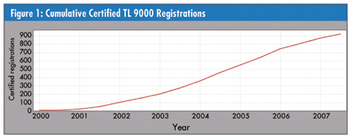

What leads us to believe that the standard has been successful amid the continuing industry and technology revolution? TL 9000 registrations have grown consistently from 15 in 2000 to more than 1,000 registered locations worldwide today, as service providers and suppliers accept and adopt the standard, as seen in figure 1, below.
Not only has the total number of registrations grown, but the mix of registrations has also changed as the standard is recognized globally. QuEST Forum began in North America, the brainchild of, among others, Steve Welsh, then- president of procurement for Southwestern Bell Telephone. Founding members always envisioned TL 9000 becoming a truly global standard. Figure 2, right, shows the current composition of registrations. QuEST Forum currently has active regions with volunteers participating in North America (NA); Europe, Middle East, and Africa (EMEA); Latin America (LA); and Asia Pacific (AP). The Asia Pacific regions have subregions in China, Japan, Korea, and Australasia.

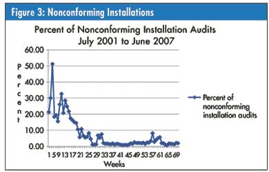

TL 9000 has had its most significant deployment and effect in the “land-line” or traditional service provider supply chain. Wireless and cable operators have yet to embrace the standard on a large scale . Later, we will discuss how and why we believe that this will change. However, the improvement in critical key performance indicators for participating organizations has been real. For instance, one problem that plagued the industry for many years was nonconforming installations (i.e., those with sufficient installation defects for them to fail a standardized quality audit). Issues like this one, as well as others such as poor on-time delivery, became a focus for QuEST Forum. TL 9000-registered installation companies are required to report measurements in these categories. Figure 3, below, shows the improvement made in nonconforming installations as measured by the percentage of nonconforming jobs to total jobs audited. Companies reduced their nonconforming jobs from more than 50 percent to less than 1 percent during a six-year period.
