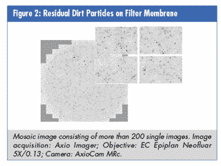

However, contamination by large particles has been and still remains a particularly difficult problem, with national and international standards requiring organizations to detect and measure dirt particles of all sizes and document the results. (See figure 1.) Currently the industry is focused on detecting dirt particles on round filter membranes. (See figure 2.)
In the automotive industry, for example, components are rinsed with a defined amount of fluid and the dirt particles washed off. The cleaning fluid is then pressed through a round filter membrane. The washed-off dirt particles are caught by the filter and can then be analyzed. The goal is to get a representative distribution of the number of particles in a given particle class (i.e., particles with similar characteristics that fall statistically in the same general category). Usually, the technician checks this result against the maximum number of particles allowed in that particular class of particles. If the inspection shows too many particles of a particular class, then the manufacturer must find out where the particles came from to avoid future contamination.

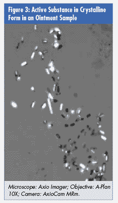

A pharmaceutical company measures active substances in crystalline form in ointments. In this case, ointments such as fungicidal preparations for the skin and mucous membranes are tested for the suitable distribution of the active substance in the matrix material of the compound, which is present in crystalline form. The samples come either from new products that are being developed or from finished tubes of ointment, the quality of which is checked during production. Under the transmitted-light microscope, the ointment is spread onto a slide and analyzed in polarization contrast using a 10X and 20X objective. The crystals of the active substance are clearly visible as dark structures and can be assessed using image analysis. To validate the system, an area standard (i.e., a circle with an area of 100 µm²) is measured each month, and the measured value compared with the reference value. One important feature of the system is the ability to detect and measure both large crystal agglomerates and extremely small particles in just one step and compare the particle distribution with the distribution stipulated in the company's standard operating process. (See figure 3.)

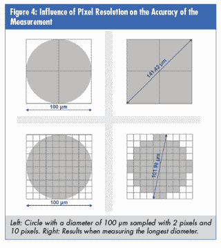

The theoretical basis for the required minimum resolution is provided by the Nyquist-Shannon sampling theorem. With regard to analyzing images, this states that the smallest detail to be resolved must be sampled using at least two pixels. When an image is recorded using a CCD camera, an imaginary grid is laid over the image, and a brightness or color value is then determined for each square of the grid. This results in a circle being imaged as a square if sampled using four pixels (i.e., two pixels horizontally and vertically, as shown in figure 4). If the original circle is 100 µm in diameter, the measurement of the diagonal as the longest diameter then produces a value of 141.42 µm.
Some guidelines therefore request, quite justifiably, that sampling should be made with 10 pixels over the smallest dimension. The measurement will then result in 101.98 µm, or an acceptable error of approximately 2 percent.

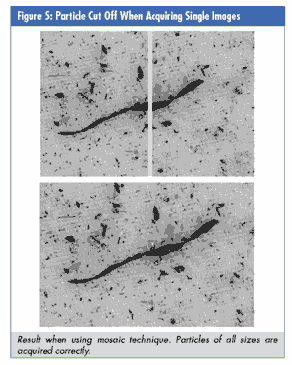

When acquiring images of small particles with the appropriate r esolution, it's inevitable that only a part of the sample is captured by the camera image. As a result, particles are cut off at the edge of the image, particularly where large particles are concerned. (See figure 5.)
Today, these problems can be solved with mosaic images. The sample is automatically moved via a motorized stage, and single images are acquired in each position. These single images are then put together to form a large overall image. This solves the problem of particles being cut off as long as the movement of the stage is accurate enough. Theoretically, the stage reproducibility should be better (i.e., a lower number in microns) than the pixel scaling. A typical value for this reproducibility is approximately 1 µm, which is sufficient for the pixel scaling seen in figure 4. What can you do if this isn't enough? There are two possibilities. Either use a motorized stage that's more accurate (and much more expensive) or use a stitching algorithm, which recalculates the correct positions of the different images relative to one another. The disadvantage of a stitching algorithm is time. You must acquire images with an overlap factor and subsequently do the stitching. This is the reason why most people avoid using software stitching, if possible.
