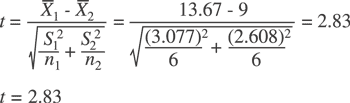

Step 3: Calculate statistical t value:
Step 4: Make a decision:
a) Look up tabular t value in a statistics textbook. In this case, it’s equal to 2.2281. (Note: You have 10 degrees of freedom.)
b) Compare this to the value from step 3 of 2.83. If it’s greater, reject; if not, accept.
Interpretation: In this case, the mean values are different enough from each other that one would conclude that lines 1 and 2 are indeed different from one another.
