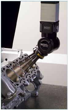

High-speed, infinite-position measurement has enabled new approaches to probing. For example, helical scanning can greatly speed the measurement of bores while generating thousands of data points to determine roundness, concentricity, or taper, as seen in the images at the left side of this page and above. A sweeping scanning routine can capture the edge geometry of a turbine blade by tracing back and forth from each side of the blade.

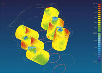

A leading automobile manufacturer has assessed the system’s massive data-capture capabilities to measure engines for wear analysis and cylinders for their deviation in spatial orientation. The captured data are compared against new-engine specifications; colors are assigned to the wear deviation to generate graphics similar to a thermal scan, as seen in the image below.

The two illustrations below show how the head can quickly perform a complex helical scan.
