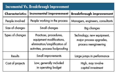

Annex B of ISO 9000:2004--"Process for continual improvement," briefly describes the distinction between breakthrough and incremental improvement. Maintaining a clear understanding of this distinction is important for an organization committed to improvement because it's easy to use inappropriate improvement tactics. The distinction between both kinds of improvements is shown in the figure below. There are potential traps in the continual improvement concept when organizations expend large sums of capital to achieve small gains or expect great gains from employees with no improvement budget. Recognizing the distinctions and applying them to each opportunity is key to achieving planned improvement.
