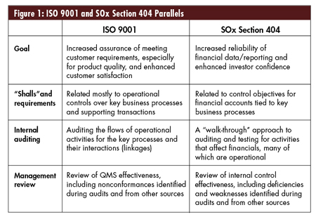

A QMS such as ISO 9001 can provide objective evidence that an organization is operating with the proper controls, policies, procedures and practices. ISO 9001 gives attention to the operational controls--such as booking customer orders, purchasing raw materials, fulfilling orders, and handling customer returns and complaints--that help ensure customer requirements are met. Those same operational controls are the foundation for much of the organization’s financial data (e.g., inventory, revenue, customer credits and/or allowances). Even ISO 9001’s requirements related to job duties, responsibilities and communications throughout the company contribute to the “control environment” that’s so important for the credibility of financial information.

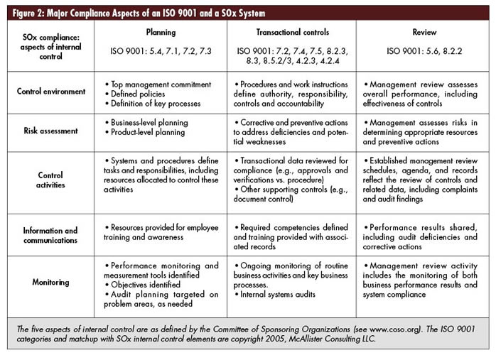

The article “Leveraging Your ISO 9001 System for Sarbanes-Oxley Compliance” (Quality Digest, February 2005) introduced some of the linkages between ISO 9001 controls and the related operational controls that directly affect financial data. The five key aspects of internal control identified by the accounting community--control environment, risk assessment, control activities, information and communications, and monitoring--align with various operational controls in an ISO 9001 system.
This alignment is a good jumping-off place for using your QMS in support of SOx compliance.
