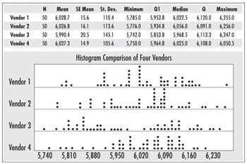

Here’s an example. Say you’re considering four vendors for a big contract. You’ve requested that each make a run of product that will supply you with 50 random samples for SPC calculations, as well as the lot’s production control chart and its Rbar/d2 estimate of standard deviation. Your specification range for this quality characteristic is 5,700 to 6,300. Regarding costs: vendor two < vendor one < vendor four < vendor three.
Your quality assurance lab comes up with a summary of the four lots based on the samples provided and produces the following comparative histogram:

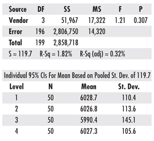

Your company’s statistical guru cautions that the data for vendors three and four aren’t normally distributed: “Vendors one and two both pass the normality test with p > 0.05,” he says, “although vendor four doesn’t quite fail the null hypothesis at the p < 0.01 level.”
His analysis of variance proves no statistical difference among the four vendors with a p-value of 0.307 and confirmed by the overlapping 95-percent confidence intervals:
Given this, should you base your decision solely on price?

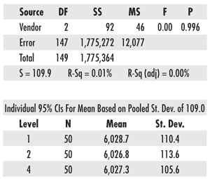

Then again, vendor three wasn’t normally distributed, had the highest overall standard deviation and was the most expensive. Obviously, its estimate of standard deviation is incorrect. So, the analysis is redone with vendor three omitted:
Looks like vendors one, two and four are virtually identical; it all comes down to price.
