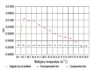

In the company's benchtop gage applications on the production floor, one temperature sensor is placed within the gage in such a way as to sense the temperature of the workpiece or the master, depending on which is in position. Another sensor is embedded within the gage hardware to pick up a representative temperature of the fixture. A single LVDT probe is used to compare the dimension of a master to a workpiece.
When the master is placed in the gage fixture and MicroComp is "zeroed," the master's temperature is sensed by the first sensor. MicroComp immediately corrects for any difference in temperature of the master from 20° C, which would otherwise cause the gage to be calibrated inaccurately from the outset. This is usually the case with comparative gages that don't compensate for temperature.
It also monitors the temperature of the gage fixture that's being read by the second sensor--the gage sensor--and compensates in real time for any temperature-caused change in the gage fixture's size. As parts are measured, the first temperature sensor makes contact with the bearing ring and takes its temperature within two or three seconds. The correction algorithm is applied using preprogrammed coefficients and the calculations for master and gage size variation described previously. It displays a net temperature-corrected dimension on its screen. This dimension represents the true difference in size between master and workpiece that would be observed if master, workpiece and gage fixture were at 20° C.
Figure 2: Workpiece Dimension vs. Temperature
Thus, even if the plant floor is extremely hot or cold, operators instantaneously obtain close to the same measurement result they would if they were to take the part into a temperature-controlled gage room, let it stabilize during several hours, and take the measurement at a controlled temperature, as seen in figure 2.
