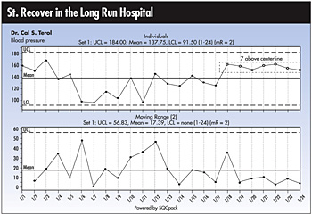

Applications of X-bar and R charts occur in health care, but individual moving range charts are far more common (sample size equals one).
One might track a patient’s blood pressure, or any other critical measure, on a daily basis. In charting this data, a different weighting factor E2 is used.
where:
UCLX = upper control limit for the individuals
LCLX = lower control limit for the individuals
k = number of samples
E2 equals the weighting factor used to estimate three standard deviations above and three below the process average.
