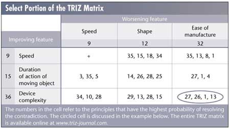

OnTech's package development has many examples of the interplay between solving a technical contradiction and a physical contradiction. For example, one difficult physical contradiction is that the outer wall must be thick so that it stays cool and users aren't burned when they pick up the coffee, but the outer wall must be thin so that the contents can be raised to a high temperature quickly during sterilization.
OnTech solved this problem by using six layers of material to separate the properties of the whole and the parts, but that solution created a technical contradiction: The complex six-layer structure was expensive to manufacture, and it was very difficult to get a good yield, especially in the double-seaming step where the edge of the wall meets the top and the bottom of the can. Using the TRIZ matrix (a portion of which can be found in the figure above), which expresses all technical contradictions in tradeoff terms, the tradeoff was:
The complexity of the system improves (Parameter 36, "Device complexity")
The ease of manufacture worsens (Parameter 32, "Ease of manufacturing")
The matrix tells us that the principles most frequently used to solve this problem are 26, 27, 1 and 13. Although the "best" answer may come from any of the 40 principles, the ones listed in the matrix are always a good place to start, because they are the ones that have been successful for other people.
In this case, the OnTech team used principle 1, "Segmentation." They divided the manufacturing process into smaller steps--instead of producing the complex system by precision blow molding, they used die stamping to cut the material to shape. The complexity of the product remained the same, but the cost of producing it went down enough to make manufacturing feasible.
