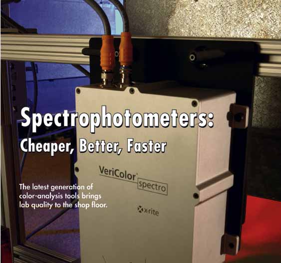

To pursue this opportunity, CCI agreed to act as one of a number of beta test sites for a new-generation spectrophotometer developed by X-Rite Inc. of Kentwood, Michigan. X-Rite's new tool can measure samples without destructive testing, match the accuracy of lab-confined spectrophotometers on a relative basis, and withstand the harsh environments of a factory floor.
There was one final key to make the system work for CCI: cost. The instrument is priced at less than $20,000 a unit, nearly one-fifth the cost of other lab-bound or noncontact spectrophotometers.
The company estimates that the instrument will pay for itself in less than a year through savings in scrap, equipment downtime, and labor.
CCI uses the system to measure color at a distance of up to four inches from the sample, which is more than adequate for CCI's needs and allows for versatility in mounting the instrument. Because the instrument does not employ destructive testing, CCI has been able to compile data as often as it wishes while the process is running. Under the destructive testing system, CCI tended to conduct tests at the beginning, middle, and end of the product run simply because of the resources required for each test.

By borrowing technology from other industries, color-instrument manufacturers have risen to the occasion by inventing robust in-line spectrophotometers for the shop floor that measure colors accurately, and at a fraction of the cost of older technologies. As a result, manufacturers can now obtain reliable data from high-speed production lines that use lean manufacturing techniques.
Manufacturers of color-sensitive products can now obtain in-line spectrophotometers for less than $20,000 that:
• Provide real-time or continuous data that match lab-quality accuracy
• Measure colors without contacting the surfaces that they're measuring
• Can read colors in a shop-floor environment with fluctuating temperatures, vibration, high humidity, and variable lighting conditions
• Don't require frequent calibration
• Have the ability to read products with varied textures

Light, innovation, technology
Manufacturers of color-measurement instruments have borrowed technology from a diverse crowd of industries--cell phone companies, ink-jet manufacturers, aerospace firms--to come up with innovative shop-floor solutions. By using components that are now mass-produced, color- measurement manufacturers have also driven down the price of their products.
There are three core reasons why spectrophotometers now offer enhanced quality and features at approximately one-fifth of the price of earlier in-line models:
• Smaller and highly reliable illumination sources due to remarkable improvements in light-emitting diodes (LEDs)
• Innovations in the manufacture of color analyzers, such as stable interference-filter arrays driven by stepper motors
• Similar improvements in the optics and detectors that view samples, and in the electronics that analyze data
The compact, intense sources of white light made possible by LEDs have been a boon to manufacturers of color- measuring instruments. Developed just a few years ago for the flash option built into high-end cell phone cameras, new LEDs offer a nearly ideal optical component for spectrophotometer use--a point source of bright light. The uniform LED burst of light allows instruments to read color samples from relatively far away.
This new, more intense light source has allowed a new generation of spectrophotometers to utilize "searchlight"- type optics that partially offset the problem of variable readings at varied distances due to changes in light intensity. Coupled with imaging optics that can be likened to using a pinhole camera to keep image sizes proportional, spectrophotometers have greatly extended their range of vision.
LEDs have other significant advantages. White light is a combination of the constituent of the visible spectrum. (Remember "Roy G. Biv," the ploy your science teacher used to teach the colors of a rainbow--red, orange, yellow, green, blue, indigo, and violet?) The light from LEDs has a flat degradation curve over time, meaning that the amount of each constituent color doesn't change much in the course of millions of flashes. The same can't be said for light from xenon flashes or incandescent bulbs. Over time, the constituent colors of their light shifts markedly, and light intensity diminishes.
In addition, LEDs can withstand high-voltage electrical currents in a very short period of time to produce bright flashes. Because they rely on solid-state physics rather than electrical discharge through a gas or heated filaments in a vacuum, LEDs are very resistant to shock and vibration and more apt to remain at a constant temperature during measurements, which reduces error. This allows spectrophotometers to operate accurately between 32°F and 120°F.
New in-line spectrophotometers offer another critical advantage when measuring colors under varying lighting conditions. These instruments detect light only from the LEDs, and ignore all other sources of ambient light. Other sources of light--incandescent, fluorescent, sodium vapor--greatly affect the way colors are perceived.
Previous spectrophotometers skirted the problem of error caused by ambient light by either relying on blinding flashes of light from a xenon flash to overwhelm any ambient light, or by the expensive process of shrouding samples to avoid ambient light. LED-illuminated spectrophotometers are much more refined. These newer instruments modulate LED pulses and tune the sensors so that they recognize only the LED light source, similar to the way a person tunes in one radio station from the many that are available in a given city.
By utilizing techniques and processes mastered by the aerospace industry, spectrophotometers are now hardened to withstand the rigors of the shop floor.
These newer instruments handle mechanical shock and prolonged vibration due in part to toughened enclosures and sealing systems, with LEDs providing a shock-resistant, solid-state method of illumination. Reliable interference-filter arrays driven by rugged stepper motors are at the heart of color analyzers that essentially break the flash of light bouncing off a sample into 31 spectral components.
Battle-hardened spectrophotometers housed in NEMA enclosures are so tightly sealed and packaged that they can withstand the pressurized hoses of a car wash without leakage. The newer spectrophotometers also work properly under dusty or oily shop conditions when protected by enclosures that direct a constant flow of filtered, compressed air past lenses and other optics.
