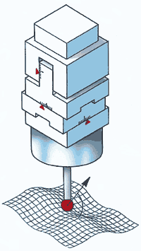

Probes are the key to accurate scanning
 Analog probes act as small, accurate auxiliary three-axis measuring machines whose readings complement those of the CMM. In the scanning process, the probe stylus is in constant contact with the part surface, and the measuring-machine control system ensures that a consistent gaging force is maintained by detecting any deviations and regulating them immediately. This force deflects the three probe axes, and high-resolution electronic transducers record the displacement. The dimensional data is continuously read from the machine scales and analog probe transducers and sent to the software for analysis.
Figure 1: CMM Accuracy
The key in providing a flexible scanning CMM is having very high and repeatable accuracy over the widest range of probe deflection.
Figure 2: Force-Deflection Linearity
The accuracy of a scanning head depends on the linearity of its force-deflection characteristics. The more extensive this linear range is, the higher the scanning speed.
 The accuracy of the data depends on the linearity of the probe as it reacts to surface changes (i.e., the force it takes to deflect the probe's stylus is proportional to the deflection, producing the same accuracy over the full range of the deflection). (See figures 1 and 2.) The more extensive the linear range, the better the probe will handle dramatic surface changes while maintaining high speeds. Studies have indicated that a linear scanning range of �0.1 mm is necessary for a scanning speed of 10 mm/s. If the linear range is smaller, the speed must be reduced.

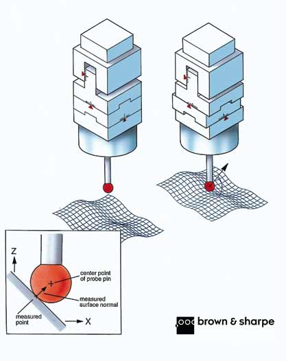

 True 3-D probe systems are "isotropic," meaning that they exert the same probing force in all three measuring axes simultaneously. Therefore, when the probe tip touches the part surface, it's deflected exactly along a vector that is precisely orthogonal to the part surface at all points (see Figure 3). The 3-D probe head is capable of precisely and simultaneously meas-uring the X, Y and Z coordinates of the contact point and the local orientation of the work-piece surface (I, J and K vectors). This feature guarantees the accuracy of the measuring process.
 In CMMs, scale readings always refer to the center of the probe tip. Its location relative to the machine coordinate system is defined through a probe calibration cycle executed prior to measuring. The purpose of the calibration cycle is to determine exactly the center and radius of the probe tip in use. Once these values are known, the software mathematically offsets the coordinates by the radius of the tip during the measuring operation. The vector normal to the probed surface at the point of contact determines the direction of this offset. With a 3-D probe, the direction of this vector is automatically determined on the basis of the readings of the three probe axes. The bending of the probe stylus can also be calculated and compensated. This permits the use of very long probe-tip extensions to allow full accessibility to all work-piece features.
True 3-D scanning probes are particularly suitable for the inspection of convoluted surface parts (such as gears, cams, rotors and hobs) where the measurements can't be made in machine axes but must be made with 3-D movements, requiring a precise determination of the surface points to define the part's true geometry.
Figure 3: Operation of a 3-D Scanning Head
Three-dimensional scanning heads can measure the probing force in all three axes simultaneously for precise acquisition of 3-D surface points.

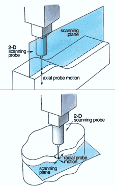

 Simpler 2-D probe systems are not as accurate. These probes, not being isotropic, cannot retrieve the part surface vectors and perform real 3-D measurements. These probes have two operating modes: the axial-scanning mode and the radial scanning mode (see Figure 4). In axial scanning, only the axial-probe axis is free to move while the other two axes are locked. This mode is used for profiling (i.e., for scanning profiles lying in planes containing the probe stylus). In radial- scanning mode, the axial probe axis is locked and the other two are free to move. Radial scanning is used in contouring (i.e., for scanning perimeters lying in planes orthogonal to the probe stylus).
Figure 4: Operation of a 2-D Scanning Head
Two-dimensional scanning heads cannot use all three probe axes simultaneously. Probe size compensation takes place in a plane, not in space, and measured point positions are affected by an "out-of-plane" error.
 Two-dimensional probes are able to compensate for probe-tip size in the scanning plane only--not in space. Consequently, each measured point is affected by a cosine error. This "clamped probing" technique is not suitable for the inspection of convoluted surface parts (such as gears, cams, rotors and hobs) where the measurements must be made with 3-D movements.
