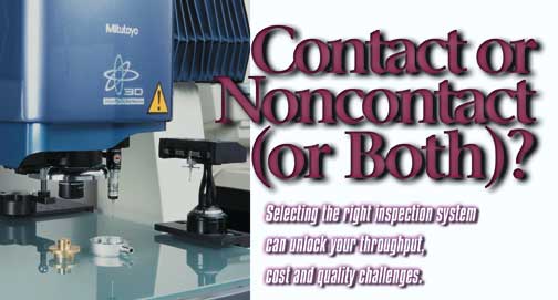

  Standard 3-D vision systems offer all of the automation features and measurement capabilities of contact-type mechanical CMMs, but they do so without actually making contact with the part. Instead, images are generated by high-resolution video in combination with microscope optics, with edge readings on a gray scale of 0-255 for more accurate resolution and finite-edge detection. A video system discerns edges and line straightness much more precisely than one that depends on the human eye. That's because it relies on the video camera to capture the shape and measure on a pixel level. Vision systems will do the job faster than a microscope or profile projector due to their larger field of vision and program/automation features. Computer numerically controlled (CNC) video systems and vision systems can measure parts up to 32 x 32 x 6 inches and weighing up to 22 pounds.
  Economy-size vision systems represent a new trend in 3-D CNC noncontact systems. Typically, they're smaller and correspondingly lower priced than a standard CNC vision system but are functionally comparable. In essence, they're small vision systems for near the price of a high-end profile projector. Both noncontact vision systems (full-size and economy) are equal in their connectivity to the plant quality assurance and computer database. A typical economy-size unit is a benchtop configuration with a measuring range of 8 in. X-axis, 8 in. Y-axis and 4 in. Z-axis. They're programmable and work by CCD (video) imaging, but are for smaller parts and smaller workloads. Video imaging grayscale users are assured of very powerful (in terms of accuracy and repeatability) edge identification.
