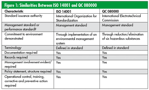

In making your decision, it’s helpful to understand where they intersect and diverge. To the uninitiated, they appear to very similar, as seen in figure 1 below.

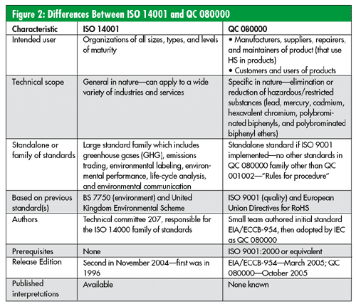

Can your organization pick either ISO 14001 or QC 080000, because they appear to have parallel requirements? Or are the differences more pronounced than the similarities? See figure 2 below for a closer look at these differences.
