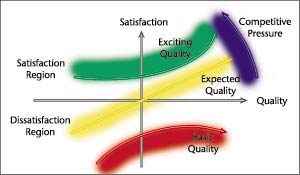

 Progressive people in the six sigma camp move beyond defining quality in terms of defects and defectives. This group looks for critical-to-quality (CTQ) characteristics in a product or service. CTQ features are those that customers expect and consider explicitly when evaluating product or service quality. A product or service that doesn't provide the CTQ features that customers expect suffers lower customer satisfaction. But even this definition isn't enough. The problem is illustrated by the Kano model of customer satisfaction (see Figure 1).
Garden variety six sigma                                        Figure 1: The Kano Model
only addresses two-thirds of the Kano model: Basic Quality features and Expected Quality features. When six sigma addresses nonconformances and defects, it's focusing on the Basic Quality curve in the Kano model. When these items are handled perfectly, the result is a customer who is not dissatisfied. This is certainly important, but "not dissatisfied" is hardly a rousing endorsement of a product or service.
 Six sigma activities that seek to identify CTQ characteristics address the portion of the Kano model on and below the line labeled "Expected Quality." If all CTQ characteristics are properly produced, the result will be a satisfied customer. Important, of course, but is it enough to simply satisfy the customer?
 Even perfection in these areas won't ensure that the organization remains viable in the long term. The Competitive Pressure curve on the Kano model indicates that market forces will make today's expected quality features tomorrow's basic quality features. Long-term success requires the customer to be excited by unexpected innovations provided by a company's products and services: Continued survival requires that your organization continuously innovate. Innovation is the result of creative activity, not of analysis. Creativity can't be achieved "by the numbers." In fact, excessive attention to a rigorous process such as six sigma actually detracts from creativity. The creative organization is one that exhibits variability, resource redundancy, quirky design and slack. It's vital that the organization keep the Six Sigma Management Paradox in mind: To attain six sigma performance, we must minimize process variability, slack and redundancy by building variability, slack and redundancy into our organizations.
