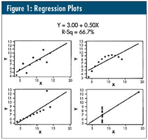

Figure 1 displays four plots from famous data sets developed by F. J. Anscombe. They all have the identical regression equation and analysis (all summary statistics).

I’m guessing that this is a spurious result similar to the lower right-hand graph in the figure. Also, did you know that there are three diagnostics that need to be done with any regression… even if it has a good R-squared and statistically significant t-test?
