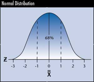

 Is Simsack's approval justified because every X-bar is within the control limits?
a. Yes, this process is in control because all of the data points lie within the control limits. If a few have been eliminated, this won't affect the outcome in any substantial way.
b. No, Simsack is dead wrong about this one. The process is clearly out of control.
(answer)
 The answer is no. Sometimes things are a little too neat for their own good, and that's the case with this data.
 When a process is in control, one can expect the X-bars to form a normal distribution between the upper and lower control limits. This is based on the central limit theorem, a concept that you can learn more about by downloading Quality Gamebox from www.pqsystems.com. If the data formed a normal distribution, the X-bars would appear as follows:
 By moving plus and minus one standard deviation in a normal distribution, one can expect to find about 68 percent of the X-bars. In the chart that Dormat brought to Simsack, 100 percent of the X-bars lie within plus and minus one standard deviation. The Greer, Grate & Gate chart reflects a situation that seems too good to be true, and in fact it is.
