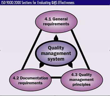

One of the most important objectives of an internal quality audit is measuring the effectiveness of an organization's quality management system. For this to happen, executive management must first meet its overriding responsibility of establishing and maintaining a system regarding quality policy, goals, resources, processes and effective performance--including monitoring and measuring the system's effectiveness and efficiency.
 ISO 9001:2000 delineates this responsibility into three distinct areas: 4.1 General requirements, 4.2 Documentation requirements and 4.3 Quality management principles. If an organization's executive management isn't active in these three areas, then they won't be addressed and the quality system will be ineffective. Let's look at them one at a time, first in terms of their meaning and then as auditable characteristics.
Management system general requirements
 With respect to quality, an organization's fundamental responsibility is to define the management system used to ensure and safeguard quality. This task begins by identifying the process applications that will be part of the quality system. These should be integrated and coordinated to achieve system objectives; i.e., the processes must be organized in a process approach and supported with necessary resources. Also, the quality system's performance must be continually measured for effectiveness and efficiency, and active improvement structures must be developed.
 A quality management system is profound in its application, extending to each level of company activity that affects product and service quality. Yet it also includes customer and supplier participation and is, therefore, very broad in its scope. At this point, it's understandable to wonder if anything as all-inclusive in its reach and high-minded in its goals can even be auditable. The answer is that nothing is auditable until it's implemented, but once implemented, everything's auditable.
 Section 4.1 of the ISO 9001:2000 standard describes quality system requirements, but with the exception of documentation, implementing the system is affected in other sections. In other words, when all the requirements described in Section 4.2 and in sections 5-8 have been audited, the quality system has been audited. Therefore, we'll instead consider the standard's documentation requirements.

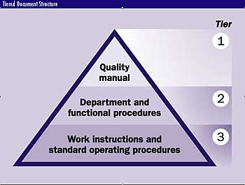

 This system is referred to as a "tiered documentation structure." Tier one, the quality manual, contains policies and responsibilities related to ISO 9001 requirements and expresses top management's written commitment to quality. It also contains the list of tier-two quality documents and associated revision lists and defines the manual's distribution list. The manual also may contain a few company-level procedures, such as steering committee procedures.
 Tier two, department procedures, explains responsibilities, provides the department's organization chart and describes the input and output interfaces of its processes. Also, just as the quality manual in tier one provided an index of tier-two documentation, tier two provides an index of the department's tier-three procedures.
 Tier three describes work instructions and standard operating procedures. A work instruction, sometimes called a "standard operating procedure," describes step-by-step how a task is to be done. To avoid confusion, a work instruction should be distinguished from a "job description," which describes what tasks an employee performs. For example, a work instruction for a lathe doesn't describe how to do machining; it describes how to set the machine up. Similarly, running a test on a centrifugal chiller requires highly skilled electronic technicians. Despite their skill, the tests also require work instructions (e.g., loop-temperature and pump-pressure ranges) that describe test-station setup for the particular kind of chiller under test. The purpose of work instructions is to establish conformance between the machine's or equipment's range of operation and the specifications on the job order.

 Given the quality manual's scope, an auditor might feel overwhelmed by its sheer volume, but the naturally tiered structure of operational documentation helps to get a grasp on it. It's best to start at the top and examine documents on a sampling basis.
 As the illustrated pyramid suggests, the number of documents increases greatly as you descend the tiers, but the total is united by an index system. The quality manual will index tier-two documentation. Each department procedure will index its own tier-three documentation. Choose a sampling method before you examine the indexes; then select documents randomly within the constraints of the audit scope.
