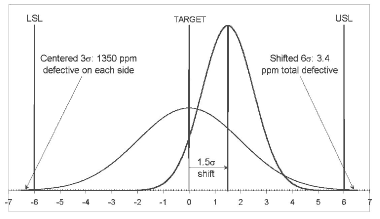

Figure 1: Six-Sigma Process with +1.5s Shift
vs. Centered Three-Sigma Process

 Let's take a closer look at the difference between three-sigma and six-sigma processes under the assumption of normality, which is critical to the calculations that follow. (The assumption of stability is also critical. Without it, one cannot predict the operation of the process or state probabilities.) Figure 1 illustrates a three-sigma (centered) process and a six-sigma (+1.5 s  shifted) process. Both process distributions appear to be entirely within the product specifications.
 We define LSL as lower specification limit and USL as upper specification limit. The target, T, equals (USL + LSL)/2. For this example, we chose T = 0, USL = �6 and LSL = +6 for ease of explanation.
  We have traditionally operated at the three-sigma level. Given the specifications, the process variation (s) must be small enough so that the base of the normal distribution fits within the specifications, when the mean equals the target. That is, the length from m - 3s to m + 3s, a length of 6s , must be less than USL � LSL. Hence s = (USL � LSL/6) is the largest variation allowable. The figure illustrates this situation with a normal distribution where the mean, m , equals 0, and the variation, s, equals 2. A process operating in this mode will produce 2,700 parts per million (PPM) defectives, with 1,350 PPM beyond each specification limit. And should the process mean shift to m = t  � 1.5s (which would be � 3), then it would produce 66,807 PPM defectives.
 Following the same reasoning as was given for the three-sigma process, a process variation of s = 1 or smaller is required to achieve the six sigma objective [s = (USL � LSL)/12]. If the six-sigma process mean were centered on the target value, the process would produce defectives at a rate of two parts per billion (PPB), one PPB beyond each specification limit. Should the process mean shift by 1.5 sigma, the defective rate would increase to 3.4 PPM defectives. The figure illustrates the latter situation, with a normal distribution where the mean, m, equals 1.5, and the variation, s, equals 1.
Note that every process has a variation that can be estimated through a process capability study. It isn't determined by the specifications of the product being produced. Here we are determining how precise a process must be to accomplish a three- or six-sigma objective for the product. P.R. Tadikamalla showed that the 3.4 PPM rate could be obtained in other ways depending upon the process spread and the process shift.
