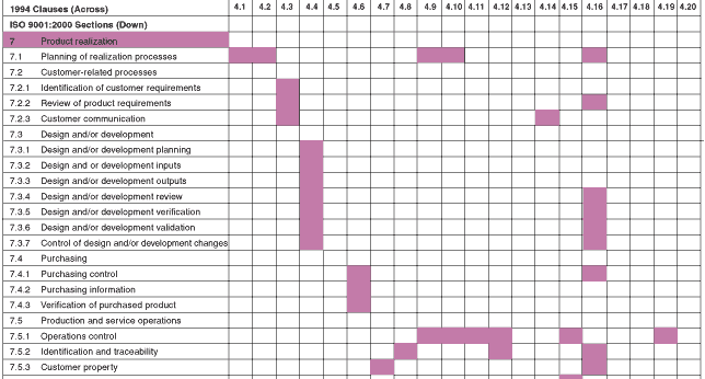

M any of the clauses from ISO 9001:1994 are incorporated into ISO 9001:2000's section 7, Product realization. This section groups the requirements from the 1994 version's clauses 4.3, 4.4, 4.6, 4.7, 4.8, 4.9, 4.10, 4.11, 4.12, 4.15 and 4.19. This section also addresses process planning and customer communication and is the only section of the standard that allows exclusions to the requirements. These exclusions must not affect the organization's ability to provide products that meet the customer's requirements. Also note that although clause 4.13, Control of nonconforming product, is closely connected to product production, it is represented under section 8, Measurement, analysis and improvement.
 Exercise some care when reading section 7, as the vocabulary has been modified even though the requirement's purpose remains the same. For further clarification on how the ISO 9001:1994 requirements cross-reference to those in ISO 9001:2000, refer to the matrix (Figure 1).

Figure 1: ISO 9001:1994 Product Realization Clauses Cross-Referenced to the ISO 9001:2000 DIS
