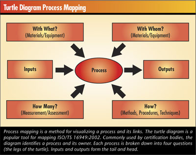

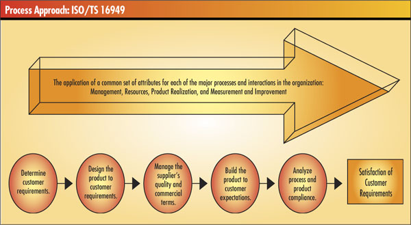

ISO/TS 16949:2002 made a great leap from the 1999 version’s vertical breakdown of the process approach. ISO/TS 16949:1999 divided organizations into distinct units--also called the “silo” approach--and assessed each part as a separate entity. This didn’t account for the sequence and interaction of their processes.
“The process approach is horizontal,” Rogers says. “A process is a set of interrelated or interacting activities that transform inputs to outputs. It considers the entire system and its linkages. The process approach can look at the links within an organization and confirm that they’re functioning or if there’s a disconnect. Determining disconnects opens opportunities for improvement not previously recognized under QS-9000 or ISO/TS 16949:1999.”
Determining what customers require will help an organization develop its quality management system. The figure on page 25 illustrates how customer requirements are applied to each step of a product’s life cycle. The final output should result in customer satisfaction.
The process approach begins and ends with the customer. “Jumping from an elemental approach to the process approach is a challenge,” Pratt admits. “The key isn’t just containing problems discovered while implementing and auditing ISO/TS 16949, which may be a temporary fix, but also addressing daily business with the links in mind.”
