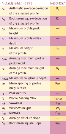

                                                            | B46.1--1995 vs. ISO Parameters

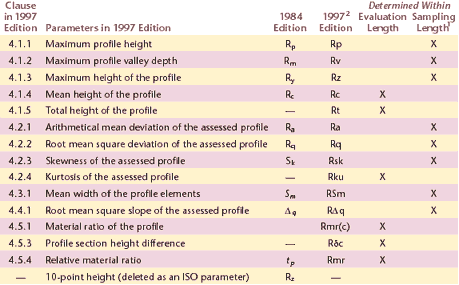

                                                            | Comparison of Parameter Symbols Between ISO 4287-1:1984 and ISO 4287:1997
