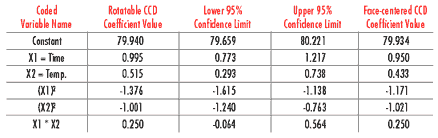

Reason 2: Insufficient difference in effects estimation
Table 2: Regression model Coefficient Data--Exanmple 14-2 From Montgomery
Table 2 presents the estimated regression model coefficients and corresponding �95-percent confidence intervals from Example 14-2 of Design and Analysis of Experiments by Montgomery for the yield response. The last column in the table presents the estimated coefficients using a 13-point face-centered CCD for the same variables. The actual yield data from Example 14-2 were used for the center points and factorial design points that the two designs have in common. Predicted yield data were used for the face-centered axial design points. The predictions were obtained using the regression model from Example 14-2 with a correctly propagated experimental error added to each predicted value. As the Table 2 data show, the face-centered CCD coefficients are all within the rotatable CCD coefficient �95-percent confidence intervals. In fact, a comparison of the estimated coefficients for the two design types clearly shows that they are either identical or nearly so in all cases.
