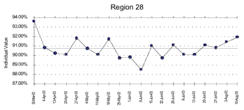

I hope my recent columns show the futility in doing this until the true process behavior and/or variation has been assessed by "plotting the dots." The run chart for one of the 28 regions is shown below (median = 90.75).
No trends of seven and no individual runs of eight or more all above or below the median: It's common cause! To further confirm, a control chart could also be generated, and the common cause limits are [87.6–93.8], between which all data fall (and none of the classic nine tests for special causes are triggered). Thus, any number in that range cannot be given a traffic light interpretation--in fact, given a process-oriented definition of "meeting target," it was meeting it all along.
From another routine control chart calculation, consecutive weeks can differ by as much as 3.9. You'll notice that no weekly difference even comes close to this value; the largest difference is 2.8. Of course, one can almost predict the weekly "Why are we up?" and "Why are we down?" questions and people subsequently looking for reasons… and finding them.
Despite all the efforts, time and energy being spent to improve this process, there's been no change from April through August. Special cause strategies were being applied to a situation whose variation was common cause, which just adds complexity and, as can be seen in this case, no value.
