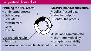

 To help introduce you to this core, let's review the general concept behind each of the 20 elements of an SPC system. While ISO 11462-1 details each element, we'll just be highlighting the key points of Section 7.
 The ultimate point is that Section 7 provides guidance on the operational elements of an SPC system. These elements can be thought of as roughly paralleling the plan-do-check-act model. Considering these key operational elements as part of an SPC version of the plan-do-check-act cycle will not only provide consistency with an ISO 9001:2000-conforming QMS but will also make the implementation of SPC easier to conceptualize and execute.
Plan
 Planning the SPC system encompasses the first three of the 20 clauses in Section 7, but it's probably the most critical aspect. If you don't plan your system right, you won't be able to control your processes effectively.
 Clause 7.1, Process documentation and control plan, outlines a planning step related to the ISO 9001:2000 clause of the same number on planning of product realization processes. Implementing organizations must fully understand the process and develop a plan of control to ensure the process will meet requirements. This includes use of techniques to understand process inputs, outputs, flows, measurement points and boundaries. Understanding these aspects of each process can help identify which process parameters affect product conformity. It is then that you should determine the process parameters that can be monitored and measured to ensure conformity of product. Clause 7.1 also recommends that organizations plan the actions to be taken when out-of-control signals are detected.
 Clause 7.2, Definition of process targets and limits, provides guidance on developing the target values and limits for each parameter, beyond which an organization would consider a process unacceptable or unfeasible. ISO 11462-1 indicates that the target setting process should be dynamic so that targets and limits are properly set and updated as conditions change.
 The final clause that provides guidelines on the planning process is 7.3, Measurement system evaluation and control. Because the measurement system needs to be evaluated to ensure that its uncertainty is known--which will help prevent false alerts that a process is out-of-control or the output of nonconforming product--the standard gives some simple guidelines for accomplishing this.
Do
 Measurement, monitoring and controls also involve three of the 20 clauses in Section 7, but they relate to the application of the SPC system to the QMS. They are also spread out within Section 7. These clauses involve the actual role of SPC in supporting day-to-day operations and the functioning of the QMS.
 First, Clause 7.6, Process data recording and collection, discusses the need to design a data collection system usable in an organization's actual operational environment. The data collection system should be carefully designed so that it will yield the needed data. The organization implementing an SPC system using ISO 11462-1 will need to answer such questions as what will be measured, what the sample size is, where in the process the measurement is to be taken and who is responsible for the sampling.
 Clause 7.6 introduces a number of other considerations for an organization, including the need to provide proper measurement equipment as well as any training needed for the equipment's use.
 Clause 7.12, Process output monitoring system, then states that an organization should track the outputs of its processes and collect the data so that the processes can be analyzed. The monitoring system should include a mechanism to initiate a reaction to problems and to identify and take advantage of opportunities for standardization on best practices.
 Finally, Clause 7.13, Process control system, involves controlling the process that creates the product. The standard provides several options for such process control systems, each of which addresses the need to monitor and measure process parameters to ensure that they meet process requirements. If a parameter is outside its limits or undesirable patterns are detected, correction and/or corrective action is needed to bring the process back into control. As its title indicates, ISO 9001:2000's Subclause 8.2.3, Monitoring and measurement of processes, also requires these Clause 7.13 processes, so the guidance provided in ISO 11462-1 may be helpful in meeting Subclause 8.2.3's requirements.
Check
 Assessment of variability and communication of analysis results is perhaps most important to the SPC system's effectiveness because the information an organization obtains as a result of planning and doing and on which it will act leads to improvement of the SPC system and also of the QMS. Three clauses focus on checking activities:
  7.14, Short-term variability assessment, recommends activities that should be considered in developing a process for assessing process changes that occur during a short period of time and typically involving a limited number of factors.
  7.15, Long-term variability assessment, provides guidelines for assessing long-term process capability once assignable causes have been eliminated and the process is in a state of statistical control. Long-term assessments are viewed as building on the changes taken or identified as needed because of the findings of the short-term efforts.
  7.16, Communicating the results of process analyses, covers communication of process analysis results to those who design and operate the processes as well as to leaders and others as necessary to achieve the SPC system goals. Communication of process analysis results is one of the things organizations should consider when addressing Subclause 5.5.3, Internal communication of ISO 9001:2000.
Act
 Using the analysis results is the focus of the guidance in Clause 7.20, Process improvement, optimization and troubleshooting, which by itself is the action clause. All the data collection and analysis is just wasted activity if it's not used to achieve results, thus completing the continual improvement loop successfully. Once long-term process variability has been studied, it's possible to prioritize processes to be optimized and improved. Clause 7.20 suggests several types of approaches for taking actions to correct, control and improve the processes.
 After establishing priorities, an organization can use ISO 11462-1's guidance to improve or optimize the priority processes. SPC and business goals should be considered during the improvement activities. These concepts related to process improvement and optimization may help organizations develop effective mechanisms to meet the requirement of ISO 9001:2000 Subclause 8.5.1, Continual improvement.
