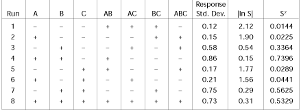

 Consider the following experiment where three factors are examined, each at two levels (a traditional 23 experiment). In this scenario we want to minimize variation. For each experimental condition or "run," we'll calculate the standard deviation of five repeated observations obtained during the run. Alternatively, we could replicate the experiment five times to get a better estimate of the combined experimental and natural process variation, but that could become very expensive. The topic of repeated observations vs. replicated experiments (as in this case) merits a whole new discussion.
 In this example we want to minimize the variation of the weight of a hot-melt adhesive stick. The factors are:
A Temperature of the molten material:
� = 300�; + = 335�
B Fill rate: � = 300 g/sec; + = 45 g/sec
C Nozzle orifice type: � = oval; + = rectangular
 The design matrix and data are shown in Figure 1.
Figure 1: Design Matrix and Data

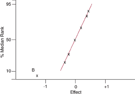

 1. Normal probability plot. This method involves plotting the effects (for the factor's contribution to the response) using normal probability paper. The vertical axis is the cumulative probability density function, or its estimate, such as the percent median rank and the horizontal axis representing the effect. This technique assumes a normal distribution, and such an assumption is supported with a single straight line. If most of the points that form a straight line fall near zero (with respect to the horizontal axis) with exceptions falling to the right or left of the "straight" line, we conclude that the effect is statistically significant. In the case of variation as the response, we must transform the original data in some manner to develop the effects such that they will be more normally distributed. One of the more popular transformations is to take the log or natural log of the standard deviation and then calculate the effects. In our example, we take the absolute value of ln S, making our objective to maximize this response, thereby minimizing the variation. The estimate for the percent median rank (vertical axis) is determined using Benard's method.
where i = the ascending order of the effect and n = the number of effects (n = 7, including all interactions).
 The effect is calculated by taking the difference in the average response where the factor is set "+" and the average response when the factor is set "�." See Figure 2 for the completed normal probability plot.
Figure 2: Normal Probability of Effects Based on |ln S|
 As Figure 2 shows, the only significant factor in terms of variation is B. To minimize variation, we must maximize the transformed response, |ln S|. Because the B effect is �1.20, we must set B to the � setting. The fill rate should be set at 30 g/sec.
 The seven effects plotted represent the three main effects, the three two-factor interactions and the single three-factor interaction. The modest disadvantage to this method lies in the subjectivity of determining which points fall off the straight line drawn with emphasis around the zero-effect point.
