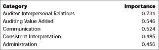

Table 1: Category Correlation to the Loyalty Category

 One of our first tests examined the correlation of our five categories to overall customer loyalty, shown in Table 1. This is a measure of how well questions in these categories track with the customer loyalty questions. This analysis was also done on the pilot survey in order to throw out groups of questions that had little correlation to customer loyalty--for example, the cost of registration.

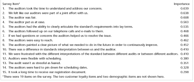

 This category correlates most highly to customer satisfaction. The items in this category might seem a bit "touchy-feely," apparently related to being put at ease, possibly by the auditor's demeanor but most likely by the sharing of information and the feeling that "We're all in this together."
 Table 2 shows the correlation of survey statements to overall customer satisfaction. The top five most highly correlated items are part of the Auditor Interpersonal Relations category. When you consider the potential stressfulness of an audit, it makes sense that the auditor's ability to put clients at ease by answering questions and explaining audit expectations could greatly influence the client's perception of the auditor and, by association, the registrar.

Table 2: Item Correlation to the Loyalty Category
