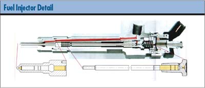

A fuel injector is fundamentally a highly sophisticated needle valve (See below). Injector ports at the bottom of the valve direct the fuel into the combustion chamber in a precisely controlled pattern, and a solenoid or piezoelectric actuator opens and closes the valve. Precision mechanical surfaces include the guide bearings, cylindrical surfaces on the shaft of the needle and body that control the needle's alignment; and the valve surfaces, mating conical surfaces that control the flow of fuel. Thirty-thousand psi operating pressures require form tolerances on these surfaces as tight as one micrometer. The critical valve seat is typically located at the bottom of a blind hole a few millimeters in diameter and tens of millimeters deep. Created by grinding, these surfaces can be relatively rough.

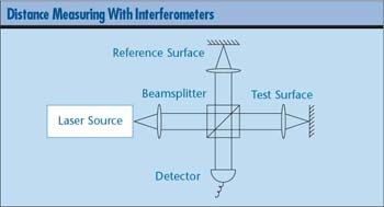

In distance-measuring applications, interferometers work by comparing the distance traveled by one beam of light, the test beam--which reflects back to the interferometer from the measured surface--with the distance traveled by another beam, the reference beam--which reflects back from a reference surface fixed at some arbitrary distance, as illustrated to the left. The interferometer makes the comparison by looking at the way in which the two beams interfere when recombined. If the crests and troughs of the test and reference beams coincide when they return to the interferometer, they're said to interfere constructively. The difference between the distances traveled by the test and reference beams must be an even multiple of half the light's wavelength. However, if the crests of one beam coincide with the troughs of the other (i.e., 180 degrees out of phase), they interfere destructively, and the distance difference must be one-quarter of the wavelength greater or less than an even multiple of the half-wavelength. Adjacent points spread over a surface will compose a pattern of dark and light bands, with the dark bands corresponding to destructive interference and the light bands corresponding to constructive interference. The overall pattern represents the deviation of the shape of the test surface from the shape of the reference surface.

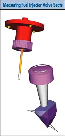

One of the most difficult surfaces to access on a fuel injector is the valve seat, which is located at the bottom of a deep, narrow hole. The ThetaForm's probe design allows the test arms of both interferometers to be delivered to the bottom of a 3.5 mm diameter by 45 mm deep blind hole, as illustrated to the left. At the end of the probe, miniature optics split the test arms into two different beams. The beams each contain both wavelengths but leave the probe at different angles, permitting measurements of two different surface types with the same probe. Because neither the part nor the probe is disturbed between measurements, the system can make relational measurements such as runout, perpendicularity and coaxiality among different regions of the part. For example, the fuel injector requires precise alignment of the guide bearing and the valve surfaces.

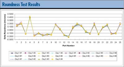

The repeatability of these measurements has proven to be quite good. We can typically achieve a standard deviation of 10 to 30 nm, depending on the parameter being measured. For example, a roundness test of the inside cone for 25 different parts was measured 20 times during a period of five days, as illustrated below. For this set of data, the average standard deviation was 11 nm.
