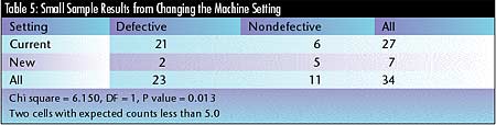

  Exact tests. So far, we've been able to get valid P values from all of the methods, but that won't always be the case. Look at what happens, for example, if the data shown in Table 5 are analyzed using the chi-square test.
 Note that the proportions and odds ratios are similar to what we obtained from Table 1, but the sample size for the "new" setting is much smaller. MINITAB's analysis now indicates that there are two cells with expected counts less than five, which invalidates the chi-square analysis and casts doubt on the P value's validity. You can no longer say with specific confidence that the two settings are different.
 One way of dealing with small samples is to use Fisher's Exact Test. Doing this with SPSS, we obtain a P value of 0.024. This P value, though larger than the one obtained using chi-square analysis, is still significant at the five-percent level.
