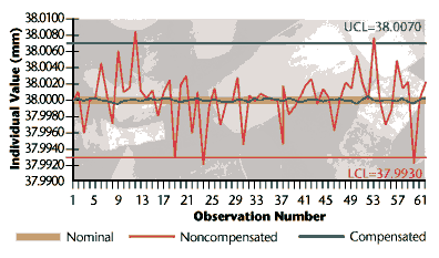

 Figure 1 shows an example of such a study. During a two-week period at a major automobile engine plant, the same crank pin on the same crankshaft was measured about 60 times using the same shop floor gage. As the graph illustrates, measurements varied by 16 microns on a part with control limits 14 microns apart--more than 100-percent variation. However, the gage used for this test had been certified to have a gage R&R of better than 10 percent. Temperature accounted for 90 percent of the variation seen in Figure 1.
Figure 1: Example of Gage Variation Caused by Temperature

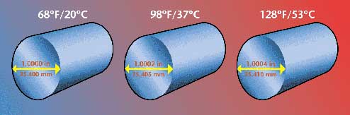

 Gage studies are generally performed in stable, temperature-controlled environments over short periods so that the effects of temperature are deliberately eliminated. However, gages are then used in shop floor environments where ambient temperatures fluctuate from hour to hour and month to month and where workpieces vary in temperature as the result of operations or seasonal ambient variations. Of course, if no further tests are performed, this fact will never become apparent. You put your trust in the gage. However, you will nonetheless be producing parts whose sizes vary significantly over time. Figure 2 illustrates the variations that can affect a one-inch (25.4 mm) diameter steel part. Other diameters of the same material would be affected proportionately. Other materials react differently; for example, aluminum parts show twice the thermal growth.
Figure 2: Comparative Outside Diameters of a Steel Shaft at Different Temperatures
 Over the long term, temperature will cause uncorrected gages to produce varying dimensions. Changes in ambient temperature won't generally cause offsetting errors in workpiece and gage; the gage and workpiece usually expand and contract at differing rates as temperatures change. They have different effective coefficients of expansion. Gages are particularly prone to exhibiting unexpectedly high effective thermal coefficients, due to such qualities as complex geometries, mixtures of components and electronic drift. They have been seen to exhibit coefficients 10 to 20 times greater than that of a workpiece. Moreover, it's worth repeating that workpieces are frequently exposed to operations that can cause their temperatures to vary--washers, coolants and machining all affect temperature--so they're frequently not at the same temperature as the gage.

 The dramatic improvement obtained by using automatic temperature compensation is shown in the results of the third run in Figure 3. In the final long-term run, temperatures were again allowed to rise by 5�C (9�F) while the same 100 parts were being measured, but in this case, temperature compensation was applied. Figure 1 also shows the difference between a temperature-compensated and a noncompensated system. These results were obtained from a regular shop floor post-process precision gage operating in a typical shop floor environment. Many such gages have successfully been adapted with temperature compensation systems to obtain similarly improved results.
