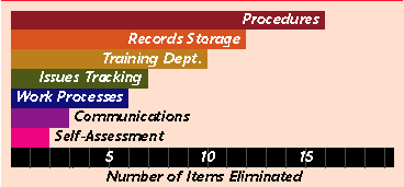

Figure 1: ISO 9000 Waste Elimination

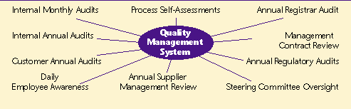

Figure 2: ISO 9000 System Within a Regulatory Environment
 The customer-owned self-assessment process didn't reach through the supplier business processes into those areas of customer-owned but supplier-utilized processes. The ISO 9002 system ensured that internal auditors, who conducted monthly scheduled ISO audits, would be reaching into Vermont Yankee procedures and therefore ensuring continuous "secondary" levels of self-assessment. Feedback from assigned regulatory personnel, who were given a presentation of the supplier ISO 9002 system, indicated a high level of confidence in that system to ensure supplier oversight, continuous improvement and timely corrective actions to concerns or contract nonconformance.

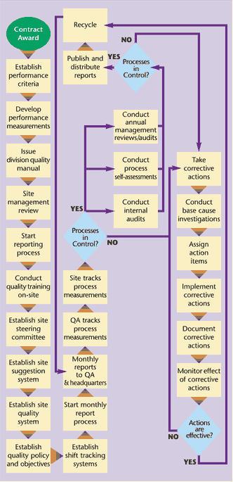

 Wackenhut Nuclear Services had a current quality plan in place at the site. That plan was reviewed and modified to fit into the ISO 9002 effort currently underway. The steering committee decided to develop a flowchart rather than rely on text (see Figure 3). That flowchart would be placed within a level III work instruction and utilized at the shop-floor level. The company purchased a special software program to enhance the new document control center computer used primarily for the ISO 9002 effort. This program developed flowcharts that could be integrated into current word processing text documents. As soon as the plan was developed and approved for use, it was evident that it could be transferred to other Wackenhut Nuclear Services customer sites as the Nuclear Division quality plan with little or no modification.
Figure 3: Site Quality Plan Process Chart
