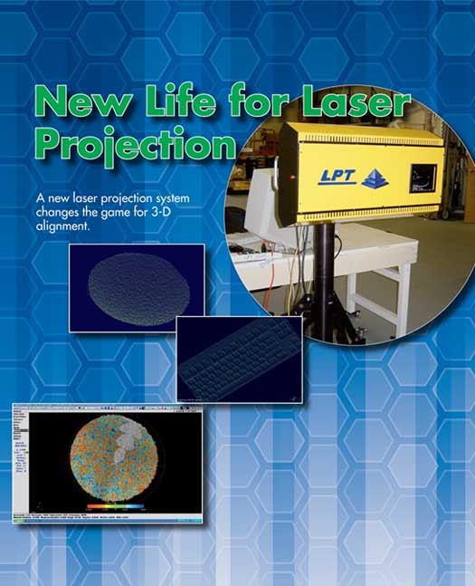

A standard laser projection system already has at least one-half of what’s required for a 3-D laser radar measuring system. You have the laser, a precision laser-steering mechanism, and a means for detecting a reflected beam. Improve on those capabilities and add the ability to measure distance, and you have a new breed of laser projector, one that can also perform large-volume, hands-free, 3-D laser scanning. Laser Projection Technologies, of Manchester, New Hampshire, is the first company to create a hybrid laser projection device capable of high-speed, 3-D laser scanning.
Recent technological advances have enabled the company to produce the LPT 100, a laser radar/projector capable of measuring 100,000 points per second with an accuracy of 250 µm at five meters. Although the accuracy doesn’t compare with a gimbaled laser-radar system, such as that produced by Metris, it is about 100 times faster. Plus, it’s still a projector. It’s this combination of laser radar and projector that has created a unique market niche for the company.
The LPT 100 has some advantages over laser trackers or other laser radars for assembly operations. First, unlike laser trackers, it doesn’t require the user to walk around a work piece with a spherically mounted retroreflector (SMR). Second, its tremendous speed sets the LPT 100 apart from other laser radars. This speed is largely due to the way that the beam is steered. Traditional laser radars or laser trackers use a gimbaled system to steer the laser beam. Gimbaled systems use very precise X and Y motors with linear encoders to move the laser steering mirror. Although accurate, the mass of the mirror and gimbals limit the speed to which they can be moved, thus limiting scanning speed. Projection systems use galvanometers in the X and Y axes to deflect a small mirror and steer the laser. The mass of this system is miniscule compared to a gimbaled system, meaning that the mirror can be modulated quickly, allowing for very fast scanning speeds.
Because of its speed and ability to project, the main application for the LPT 100 is as an assembly verification tool. This is the company’s target market, according to Steve Kaufman, president of LPT. The aerospace, automotive, and shipbuilding industries use laser projection to quickly align parts or paint stencils, for instance, but have had to rely on other equipment for verification. Although laser trackers and traditional laser radars could sometimes accomplish the verification task, they were slow and the accuracy was overkill for that application.

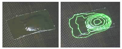

• Topographic display. A large carbon composite panel is scanned and compared to CAD design specifications. The measurement indicates a raised area, or deformity, in the panel. The system projects a topographical representation of the variation onto the piece, allowing fabricators to see the precise outline and magnitude of the deformity, as seen in the images below. The piece is immediately marked and sent to rework.
