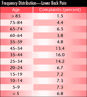

 Ismore creates a frequency distribution from the data he has available. "Wow," he says. "This is alarming data." From his chart, he concludes that the age groups that fall between 25 and 54 have up to twice as many incidents of back pain than other groups. "Who would think people that young would have so many problems?" he wonders as he ponders the possibility of publishing his findings: Instant fame. Book signing parties. Cash. He feels smug in his knowledge that Simsack would never get such an opportunity back at old Greer Grate & Gate.
 What common error--the same error made in the May 15, 2001, issue of USA Today in an article on population growth--has Ismore made in constructing the frequency distribution for his data?
 Conclusions based on this frequency distribution will be flawed because Ismore hasn't bothered to determine appropriate intervals for his data; indeed he has created two different intervals, one of five years (i.e., 20-24) and one of 10 years (i.e., 35-44). The number of low back pain incidents in the 10-year interval group would of course be larger than if it had been distributed into five-year groups.

 Ismore's error related to his selection of class intervals. Groups with larger intervals will naturally contain more data simply because they are larger. Any other conclusions are fallacious.
