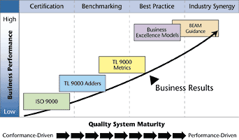

 In exploring BEMs�and organizations in general�the BEAM Work Group found that organizations often move in steps from QMS conformance to performance improvement as their quality management experience increases. Their management systems typically start with conformance-based requirements standards. QMS measurements are added, and then the systems evolve to integrate business excellence approaches as organizations build upon each previous step they've taken, as depicted in the Telecom Performance Improvement Model. However, some organizations have made the decision to bypass QMS standards and use BEMs as their primary methodology or quality management system. To be truly successful, this approach requires strong, continual commitment and leadership by top management.
 The Telecom Performance Improvement Model shows a hypothetical relationship between business results and QMS maturity, with the QMS initiatives deployed and the movement from "conformance" thinking to "performance" thinking. However, this hypothesis doesn't preclude organizations from moving directly to business/performance excellence deployment. The model does show the relative scope and impact of the various quality approaches and initiatives.
 Standards such as ISO 9001 and TL 9000 (as captured in the QMS Requirements Handbook) tend to be conformance-based, meaning there are specific, often prescriptive, requirements that must be met. If a company meets these requirements, it can claim it conforms or complies with the standard. The addition of QMS measurements with TL 9000 and the more process- and continual improvement-oriented focus of ISO 9001:2000 has resulted in these "conformance" standards progressing toward "performance," which involves continual business improvement with sustained results. To further the "performance" progression, there are BEMs, which are enterprisewide and performance-based, meaning that there are nonprescriptive, guiding criteria that outline the concepts or ideals of an excellent organization and management system.

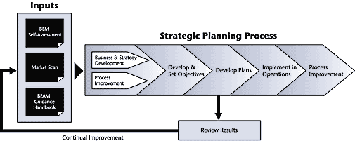

Integration of BEM and Strategic Planning Process
BEAM strategies and realizations
 The BEAM Work Group is currently pursuing various strategies to help telecom companies benefit from the experience and knowledge of quality award winners and others that have achieved performance excellence. Those strategies have focused the Work Group's efforts on several key business excellence goals, including:
  Continued development and improvement of the BEAM Work Group's Strategic Planning and Improvement Guidance Handbook, which provides business excellence guidance specific to the telecommunications industry
  Identification of good and best practices, with the goal of developing a repository to give members quicker access to resources and practices that could help them improve their processes, operations and products
  Development of processes to encourage and support the deployment of existing BEMs
  Establishment of a liaison with the BEM administrators�NIST/MBNQA and EFQM, to start�and exploration of areas of mutual interest, such as development of a telecom-specific BEM guidance document
  Promotion and recognition activities to stimulate interest in business improvement and the results that can be obtained
 The BEAM Work Group reviewed the predominant BEMs (e.g., Australian, Baldrige, EFQM and South African) and found that the same general concepts, principles and criteria were covered in all of them, with a few differences in specific criteria or in the weighting of certain criteria derived from regional preferences. Thus, the Work Group discovered that helping more organizations in the telecom industry apply the principles of business excellence was more important than having a telecom-specific set of criteria or business excellence model.
 The BEAM Work Group realized that, to assist organizations with the application of business excellence principles in the telecom industry, the industry needed guidance specific to its current problem areas and improvement initiatives. In response, the group has developed the Strategic Planning and Improvement Guidance Handbook, which provides guidance, examples and resources for specific telecom industry issues.

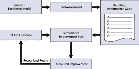

When it comes to the idea of conducting a self-assessment aimed at performance improvement, the Work Group recommends that an organization use a BEM. Which one an organization chooses is not going to make a large difference, as they differ in emphasis but not significantly in content. The insight the organization will gain can be as important as making improvements in response to gaps found during the assessment. To gain the most value from the self-assessment process, an organization would be best served by integrating the self-assessment results with the strategic planning process and/or annual budgeting cycle, as represented in Integration of BEM and Strategic Planning Process on page 34.
 The BEAM Work Group's research and analysis have so far identified the following activities a telecom company can undertake to improve its performance and thus improve the industry overall:
  Conduct a self-assessment using a BEM . This is an important first step in determining where gaps exist, what the organization's QMS and business performance levels are and where they need to go.
