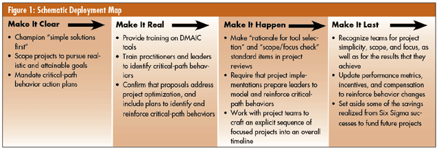

The schematic deployment map in figure 1 highlights a few steps that you can take to help your company attain more substantial and lasting business value from Six Sigma projects. These steps are recommended whether you're just now launching your initiative or are midstream in your efforts.
Make it clear
Urge all Six Sigma project teams to consider the simplest possible solutions first. Specify that complex and sophisticated approaches should be employed only when there's good reason to think that simple solutions will prove ineffective.
Just as important, projects should be scoped to pursue realistic and attainable goals. Stress that although your company values big breakthroughs, you discourage projects that are unrealistically ambitious. Emphasize that your Six Sigma strategy envisions big results in small increments.
State that all Six Sigma project teams should identify and address the critical-path behaviors needed to implement their solutions. Critical-path behaviors are the vital few actions leaders and key performers must take for Six Sigma solutions to attain and sustain targeted results. Six Sigma project plans should always address critical-path behaviors--especially those that aren't likely to occur without new forms of positive reinforcement.
Make it real
In many companies, Six Sigma training teaches participants how to use individual tools but offers little guidance on when to use them during the course of DMAIC, which tools might work in a given situation, or how to combine tools for maximum effect. The result, as previously noted, is that many teams use the whole Six Sigma toolbox for every problem.
Similarly, Six Sigma training should prepare project teams to pinpoint the critical-path behaviors required to attain and sustain their targeted process improvements. You may also provide critical-path behavior training to leaders who will be affected by Six Sigma solutions.
To reinforce that your stated requirements are real, no projects should be approved until they comply with your standards for project optimization (e.g., simplicity, scope, and focus) and reinforcement of critical-path behaviors. Enforcing those standards will safeguard against unfocused, unrealistic, and incomplete projects that enervate rather than elevate your company's performance.
Make it happen
Sitting through a Six Sigma project team update can be a humdrum experience. Slide after slide depicts detailed data and analysis. The sponsor listens politely, nodding from time to time to feign deep comprehension. When the opportune moment arises, he inquires about the one aspect of the team's work he feels fully qualified to explore: results. "Is the project on track to hit its targets?" "Will there be delays?" With these questions, many Six Sigma sponsors unintentionally convey that results are all they really care about, and that they're impatient to see the project generate those tangible outcomes. This misunderstanding, in turn, influences project teams to cut corners and engage in other self-defeating behaviors.
Contrast this with a sponsor (such as yourself) who proactively clarifies project implementation standards. You enter project reviews with your own agenda. You can ask:
"Why did you select the tools that you're applying?"
"How are you combining those tools for maximum effects?"
"What's your strategy for making your project work effectively, as well as efficiently, in terms of time and results?"
"Are you confident that the planned project scope is sound, or should we consider making adjustments?"
"What new behaviors will be required to successfully initiate and then sustain the improvements that you've targeted?"
"How will those new behaviors be communicated, initiated, and reinforced?"
Indeed, Six Sigma sponsors should be dogged on the subject of motivation:
"Have you anticipated the positive and negative consequences that people will experience as we implement your proposed solutions?"
"How will we ensure that the positive consequences outweigh the negative?"
"What in your action plan ensures that individuals will want to do what we expect of them? Are we engaged in wishful thinking?"
Such questions may make project teams uncomfortable at first because you'll be challenging them to think beyond the realm of customary Six Sigma tools. But teams will soon learn to anticipate these questions and so will realize that they must thoroughly address behavior change and motivation in their projects. Your company will then be rewarded with more complete and sustainable solutions than those realized in most Six Sigma implementations.
Another way sponsors can add meaningful value is to work with project teams to craft an explicit sequence of focused projects into an overall timeline. This will help reassure stakeholders that their interests are "on the radar screen," easing pressures teams might otherwise feel to expand current projects in misguided attempts to realize all desired outcomes at once. Similarly, you'll want to monitor your implementation to ensure that it includes an appropriate number of "replication projects" that leverage previous project solutions across your company.
Make it last
As an executive sponsor of Six Sigma, you can help sustain the effective project practices that drive consistently superior solutions. When the time comes to recognize teams, applaud how they worked as well as what they accomplished. Note specific choices that made their projects time- and resource-efficient. Recognize teams for maintaining appropriate project scope. Finally, praise the completeness of their solutions--especially their efforts to identify and reinforce critical-path behaviors.
As an executive sponsor, you can also lead efforts to weave Six Sigma solutions deep into the fabric of your company's operations. This is essential for turning successful innovations into permanent operating procedures. Use your clout to push for appropriate and timely adjustments in performance metrics, incentive systems, compensation policy, and so on. Provide leaders and employees in affected processes with immediate and tangible reasons to adapt their behaviors as needed.
Your company should also formally set aside a percentage of the savings realized through Six Sigma successes to fund future projects. Participants will see this as a clear sign that you want them to continue their improvement efforts. A competently sponsored, well-funded Six Sigma implementation will pay for itself many times over.
