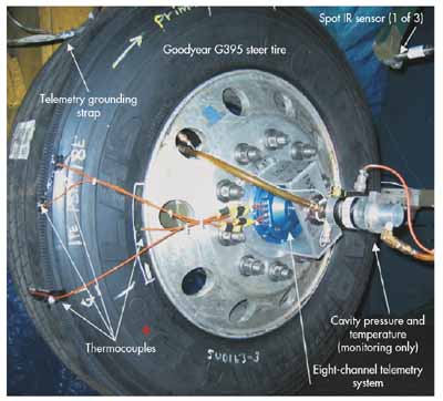

"There's a vast difference between tires running on a flat highway as compared with those running against a curved laboratory road-wheel," says Terry Ruip, technology adviser for Goodyear's tire test engineering department and chairman of the ASTM truck/bus tire test development task group. "Because of the effect of the curvature of that road-wheel upon a truck tire, the tire's temperatures are much hotter in the lab than on the road. We needed to document what those differences are so that when we develop new lab-test standards, we will have done so using realistic operating temperatures."
To do that, the task group established designs of experiments (DOEs) using typical truck-tire operating conditions. Typical of problems faced by engineers, what may be clear to them isn't necessarily clear to nontechnical people, so the results of the DOEs needed to not only make sense to nonstatisticians and to easily produce models and "what-if" scenarios. Critical to creating DOEs and presenting the data in a meaningful way to nonstatisticians is the use of statistical software.
Test setup for monitoriing tire temperature at key points

The basic objective was to build a regression model for these data that would explain the effect of tire operating conditions on internal tire temperatures. "In this particular case, we were most interested in the temperatures on the edges of the belt at the shoulder of the tire, and at the center-line of the tire," says Spadone.

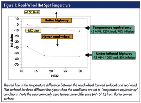

For example, the template allowed them to discover flat and curved conditions that resulted in equal temperatures at the belt-edge and center-line simultaneously for the highway and the road-wheel.
"We were looking for equivalent temperatures 'flat-to-curved,'" says Spadone. "We wanted to demonstrate that 'highway equivalent' operating conditions are required for laboratory testing to avoid tire temperatures significantly hotter than those from 'the road.' We were able to explain that using these templates." (See figure 1 below.)
Not only do the models make this clear to engineers but, more important, to administrators and managers who aren't engineers or scientists. "We could present these models in real time on the screen to show them what was going on," says Spadone. "For example, they might ask, 'What if we ran a truck tire on the road-wheel at 80-percent inflation, 90-percent load, and 75 miles per hour? What would I have to do in the real world, on a flat surface, to equal that center-line temperature?' And the answer would be that you'd have to run at 90-percent load, 80-percent inflation, and 120 miles per hour to approach the same drive tire temperatures."
Such conditions would, of course, be extreme. Nobody expects a truck to go down the road at 120 miles an hour. Once the regression models were made, most of the work was in the templates, showing different what-if scenarios and translating road-wheel conditions into real-world conditions and vice versa.
"With three variables-- inflation, load, and speed--there are lots of possibilities," Spadone explains. "So you start setting limits--for example, we set limits on the inflation pressure at between 80 and 100 percent. Most of the work was done when we built templates using the prediction equations and looked at variations on the other conditions to see where we get equivalent temperatures 'flat-to-curved.'"
