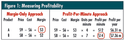

Using margin only to rank products A and B clearly shows A to be the more profitable product. However, when margin is multiplied by production run rate to create a composite profit-per-minute metric rather than a profit-per-unit one, B emerges as the more profitable product, generating $1 million more in profit than A. Company shareholders are primarily interested in return on assets (ROA), which, although generally reported as a percentage, is in reality the profit achieved during the fiscal year. From the example above, it is readily apparent that focusing on maximizing margins or emphasizing high-margin products (or customers) will not maximize end-of-year profits and ROA.

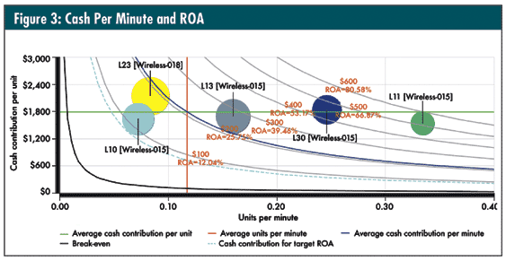

The conclusions drawn from the data shown in figure 2 are even more dramatic when presented in figure 3.
Plotting cash per unit vs. units per minute generates topographical contour lines that represent equal amounts of cash per minute. Just like the elevation contours of a geographical contour map, the contours of this "profit topo" map increase in both cash per minute and ROA by moving to the upper right of the chart. It is easily seen that the product represented by the green bubble on the right-hand side of the chart is the most profitable from a profit-per-minute perspective. Similarly, it is apparent that the product represented by the yellow bubble on the upper left, while having the highest margin, is actually below the average cash per minute indicated by the blue contour line.
Many companies realize the importance of incorporating production run rate with margin for evaluating profitability. This challenge becomes extremely difficult to solve when manufacturers have hundreds or thousands of products and customers, and multiple production facilities. Beyond being able just to combine margin and production velocity, the profit topo map enables individual products, customers, markets, sales regions, or production facilities to be displayed in this format. This makes it much easier to identify the high and low performers.

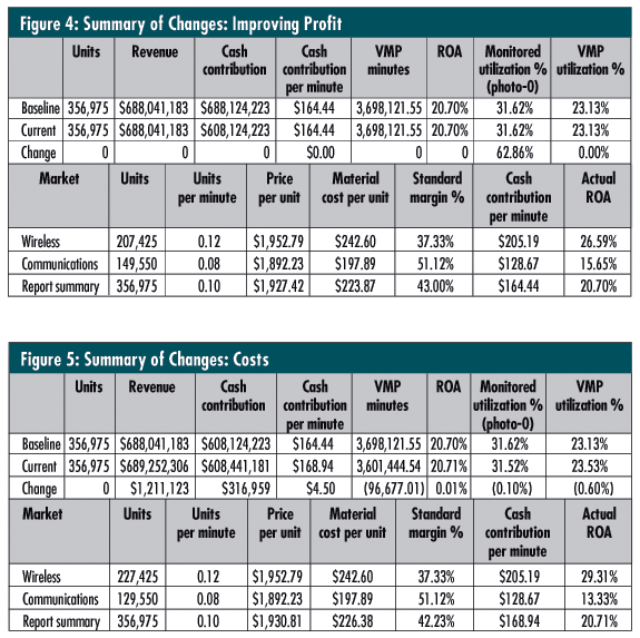

Figure 4 shows data for products sold by a semiconductor manufacturer into two different markets. The products sold to the communications market generate a higher margin than those sold into wireless--51 percent vs. 37 percent. However, based on cash per minute or ROA, the wireless products are more profitable for the company--$205 per minute vs. $128 per minute.
The manufacturer felt that it could sell more into the wireless market than it had been doing. It had not focused its sales team or marketing efforts on wireless due to the lower margins that this market produced. However, for the upcoming quarter, the company felt it could sell 20,000 more units into wireless. Because the plant was operating close to capacity, this meant cutting 20,000 units for the communications market. Figure 5 shows the effect this proposed change in product mix would have on profitability.
As the table shows, the switch in quantities for products for the two markets, although keeping the total quantity the same, was an increase in cash of almost $317,000. The production team implemented this change in its operating plan and achieved the anticipated increase in cash. The switch in product quantities also opened up more than 96,000 extra production minutes, many of which were used to fill orders for demand in other markets.

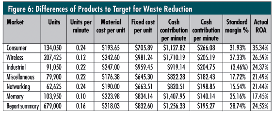

Let's look specifically at how a detailed profit-per-minute approach is helpful in reducing waste. When looking at where to reduce waste, a manufacturer might typically look at which products yield the lowest margins and target those alone. This seems completely reasonable because the company will likely have limited resources and must focus its efforts where it anticipates that it will have the most effect. However, as we have seen, the lowest-margin products are not necessarily those that generate the lowest cash per minute or ROA. Because we now understand that it is cash per minute and ROA that we want to maximize to optimize profits, we are likely to target a different set of products for waste reduction than if we were using a margin-only approach. Consider the table in figure 6, below.
Based on a margin-only approach, the manufacturer would target the products sold into the industrial market for waste-reduction efforts. However, when viewed from a cash-per-minute or ROA perspective, the industrial products are actually the third-most profitable market for the company. It is the memory market products, despite having the second-highest product group margin (35%), that yield the lowest cash per minute and ROA.

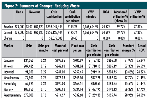

If the manufacturer's limited resources are directed to the memory market products, let's assume that this effort can reduce waste of material and thereby cut material cost by $20, from $223.98 per unit to $203.98 per unit. The net result is that cash is increased by more than $2 million, as shown in figure 7.
To be able to make this kind of targeted effort, certain things are required. First of all, the key data must all be brought into a central location, something that not all manufacturers have in place. Second, it is critical to view the data at a detailed level. The more detailed it is, the more targeted any productivity initiatives can be. Third, it must be possible to view the data from a profit-per-minute perspective, not just from a margin-only one. Certainly, any initiative that reduces waste will improve profits, and so using a margin-only approach to profitability will help cut waste and improve profits. But because waste reduction, along with any other productivity effort, is about maximizing profits, only by using a profit-per-minute approach will waste-reduction efforts maximize profitability and ROA.
