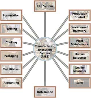

 The MES was deployed in a layered architecture between the newly developed business ERP system and the existing shop floor equipment, instrumentation and controls. As the centralized data warehouse for the entire production facility, the MES provided automatic interface to and synchronization and control of all of the functions or systems depicted in Figure 1.
 The MES architecture includes an NT applications software server, 15 NT client workstations, auto-ID equipment, process control and instrumentation interfaces, and an interface for the existing ERP system (hosted on a UNIX server) for material management functions.
