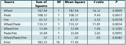

 In July, I published a column on designed experiments. My intention was to show how they could be used as tools to make process improvements. Part of my article dealt with analysis of variance (ANOVA). The way I do ANOVA is by clicking on the ANOVA icon in my statistics program, letting everything default and watching the computer crank.
 Some readers tried to duplicate my analysis. I must say I admire their devotion, and I would like to apologize to those who went to all this trouble and got results different from the ones I published. It turns out that, just as there are different ways to compute the standard deviation, there are also different ways to do ANOVA. Different people set different parameters in the model to different levels.
 As far as the July column goes, I think that, while I was using a model without a constant term, my readers were using models with a constant. The statistical analysis programs being used allow the analysis to be done either way, and there are some advantages to doing it with a constant. I didn't make a conscious decision to do the analysis without one; that was just the computer's default setting.
 Table 1 shows the results some of my readers got.
 Table 1: Analysis of Variance
Is this way of doing ANOVA right? Is the way I did it wrong? I don't know. And to be quite frank, I don't care. The important thing is to get out on the floor, collect the data and find out why the process isn't working right. Regardless of how you do the analysis, the conclusion remains the same. The most important variable in this process was the kind of wheel used to grind the ceramic.
