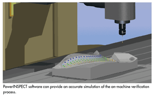

The move of the checking process from the CMM room to the factory floor means that the results need to be both quick and easy to produce and understand. Because there will no longer be specialty metrologists to interpret the data produced, making the best use of on-machine verification requires software that is not only simple enough for machine tool operators to use but that gives a quick and easy comparison of tooling or sample components against CAD data. The output must be clear, comprehensive reports that can be understood by everyone involved in the product development process, not just inspection specialists.
For this reason, PowerINSPECT software, created by Delcam, located in Birmingham, United Kingdom, has proven particularly successful for on-machine verification. The system offers a wizard-based approach to developing the inspection sequence, making it easy to generate the required probe path. An extra level of security is provided by the process simulations that can be carried out on the computer, allowing any potential collisions to be detected before the routine is run on the shop floor. The software is also very flexible, allowing extra measurements to be taken in any areas that may cause concern during the verification process.
Most important, the results are easy to understand. All measurements are initially displayed as green, red, or blue dots, depending on whether the point taken is within, above, or below tolerance. At the end of the process, reports can be generated quickly in a clear, customizable format that shows whether the part has been made accurately and highlights the areas that might cause concern.

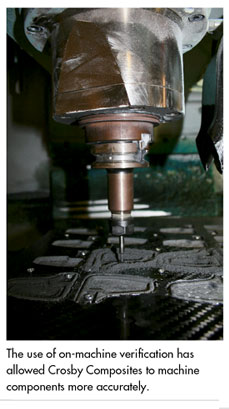

The second example is Crosby Composites, a leading composites manufacturer based in Northhamptonshire in the United Kingdom. The addition of on-machine verification has helped the company to produce composite components to levels of accuracy rarely seen in the industry. Owner Paul Crosby now uses the ability to finish-machine every part to tolerances between 0.1 mm and 0.25 mm as the key differentiator for his business.
Crosby founded his company 25 years ago and has spent all his working life in the autosport industry. He began his career as an engineer with the Mach F1 team, when the use of composites in racing cars was first introduced. “It was obvious that this was an opportunity that would get bigger and bigger, so I started my own company,” he recalls. “We began with very basic wet lay-up methods, and moved to using pre-preg and autoclave curing as the company developed.”
With composites, machined holes and pockets tend to be undersize because the material relaxes when it is cut. This effect is difficult to predict because it is impossible to cut all the fibers in the same orientation. To overcome this problem at Crosby, the initial machining operation is now followed by an inspection on the machine tool. This shows how much more material needs to be removed and enables the required extra tool paths to be generated in the company’s computer-aided manufacturing software.
For a typical component, with between 20 and 30 holes, a further cycle of inspection and machining may be needed to produce all the dimensions to the required tolerance. However, for subsequent parts, the complete machining sequence can be repeated and the results checked with a final inspection.
The first set of 17 components produced with this method was supplied to one of the F1 teams and fitted onto the car with no clashes or rework. It was the first time in the team’s history that this had happened with any set of composite parts from any supplier.
“Since then we have used on-machine verification as much as we possibly can,” says Crosby. “It ensures that we can catch any mistakes before they reach our customers. In the six months since we started with this approach, we have only had one part rejected, and that was because of just one undersized hole.”
