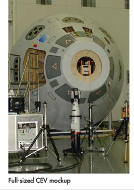

The test was made up of five key components: robot, soft-capture mechanism (also called an “attachment fixture”), crew-exploration vehicle (CEV), space-certified sensor technology, and a laser tracker with a wireless probe. At one end of a clean room, the attachment fixture was mounted onto a FANUC robot, which moved the fixture in a floating space- replicating motion. At the opposite end of the clean room was a full-sized CEV mockup positioned on its side (as seen in the image on page 21). Just inside the vehicle’s opening were three different sensor systems used to locate the fixture and provide positioning data to align the CEV with the Hubble’s attachment fixture. Finally, to the left of the CEV was a Leica laser tracking system used to verify that what the navigation sensors seemed to be detecting was really what was happening.

Requirements for measurement validation and data redundancy were also factored into the test program with the use of the high-precision Leica laser tracking system. The portable coordinate measuring machine provides a measuring rate of up to 3,000 points per second, with a measurement range of up to 40 meters (131 feet). Based on a high-speed tracking 3-D laser interferometer and precision angular encoders, the laser tracker enables scientists and manufacturers to capture 3-D coordinate data on demand, perform alignments and part mating, confirm close tolerance work, conduct complex assemblies, and more.
