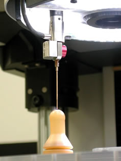

The UMAP vision system from Mitutoyo couples a noncontact vision measuring system with an ultrasonically activated probe. The UMAP103 probe is available with a stylus length of either 2 mm or 12 mm, and a diameter as small as 12 µm. The probe tip ball diameter is 30 µm or 80 µm, and is ideally suited for microhole measurement, according to the company.
"Mitutoyo's development of UMAP resulted from a specific request from Toyota Motor Co. for a probing system able to accurately measure the ports on fuel injection system nozzles," says Frank Demski, a Mitutoyo product manager. "Another requirement came from the fiber-optic connector (ferrule) industry. Medical devices, microelectronics, miniature gears and other micromachined parts are just some suitable applications."

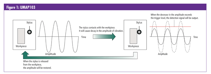

Unlike a traditional touch probe that relies upon deflection to trigger a contact, the UMAP103 depends upon the dampening of an ultrasonic field when the probe comes into contact with an object. As shown in figure 1, the UMAP103 normally vibrates at ultrasonic frequencies at a known amplitude, which is measured by the detecting circuit. As the probe comes into contact with the workpiece, the amplitude of the ultrasonic signal decreases. When the signal drops to a predetermined level, the probe is considered to have touched the workpiece. This means that the contact force is very low, generally around 1 µN.
Mitutoyo doesn't have a volumetric accuracy specification for the UMAP103 probe when used with one of the company's vision systems. Mitutoyo does say, however, that when used in the company's ULTRA Quick Vision platforms, linear accuracies of 300 nm (0.3 µm) are possible, with a repeatability of better than 100 nm.
In one application the UMAP was used to measure a 15-25-µm radius on the edge of a piece of plastic to qualify the actual radius without marking the surface of the component. One challenge was that the feature to be measured was equal to or slightly greater than the radius of the stylus. In addition, the positioning of the machine required measurement spacing of 0.5-1 µm to capture the entire edge of the radius.
A part program was created to move and retract the probe normal to the previously measured IJK vector point (a direct line from a contact point that's perpendicular to the surface, where I is used for the length of the vector projected onto the X-axis, J is used for the length of the vector projected onto the Y-axis and K is used for the length of the vector projected onto the Z-axis) to reduce the anticipated cosine error, and measurement points were taken on the flats to allow for a calculation that filtered adjacent point data that was consistent to the two to three previous points (i.e., the X- and Z-axis data was somewhat uniform). This calculation allowed the radius measurement data to use only points that showed variation relative to a radius feature.
Measurement repeatability yielded results in the submicron range for both diameter and circularity.
