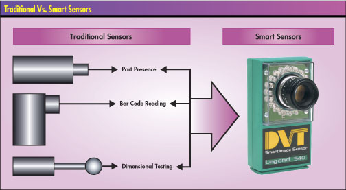

Unlike smart cameras, traditional sensors can’t be programmed. Instead, they’re limited to performing one task at a time, making a single pass/fail decision based on adjustments to sensitivity. A typical application might read the bar code on a part, perform a measurement and relay this information to the factory network. The PLC would set the part aside for rework if it didn’t meet the specification, and the work cell controller would track the part based on the bar code. With a traditional sensor, this application would be done using contact probes and a bar code scanner connected to a PC--three different hardware units performing separate tasks with separate information channels.
A smart camera can perform these tasks simultaneously with the same set of tools, completing the application at a lower cost and providing more options for flexible manufacturing. It can also convey information from more than one inspection in one communication channel.

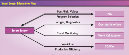

Integrating with larger platforms
Traditional sensors using serial connections make pass/fail decisions that can’t be integrated into one system but must instead travel to different systems on different paths. Because they’re not programmable, traditional sensors can’t make intelligent decisions about information. They simply make one decision based on input from one source. When a customer uses a PC and takes advantage of the familiar Windows interface, setting up a more advanced class of smart camera is easy. In this case, a powerful communications system’s flexibility can be fully configured. When standardizing on a common sensor platform, a single software package can be learned, and many different applications can be solved quickly with a common interface, as illustrated on page 22.
Smart image cameras handle information flow much more efficiently than traditional sensors. Smart cameras can perform more than one inspection at a time, sending that data in a single stream to PLCs or other devices. The data can then be easily stored for analysis or use with reject mechanisms or other components on the line. Smart cameras are commonly found in the automotive industry, where there’s an urgent need for quality, low cost and ease of use. And now, with the expanded capabilities of recent models, packaging and pharmaceutical industries also make use of the technology.
